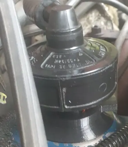

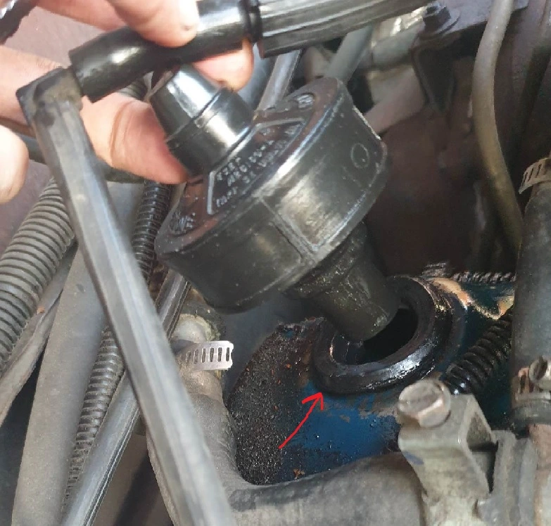

I have a 2.3l 1979 Mustang and really need a replacement grommet. This part right here -
What's it's number? The rubber on the part is so messed up, I can't read it. I've found some grommets, but not sure they fit the 2.3L block.

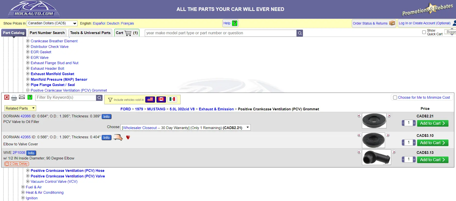

Measure the worn out one and the opening you need it to fit. Here are some 79 5.0 grommets but at least it has dimensions and you should be able to see if they are the same. Looks like two different grommets.

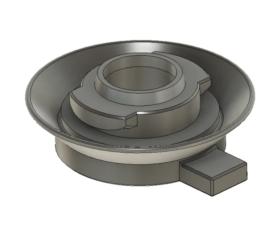

We've designed and 3D-printed the missing part out of heat (and oil) resistant thermoplastic polyurethane (TPU). Fits snugly and should work until the proper part arrives.
