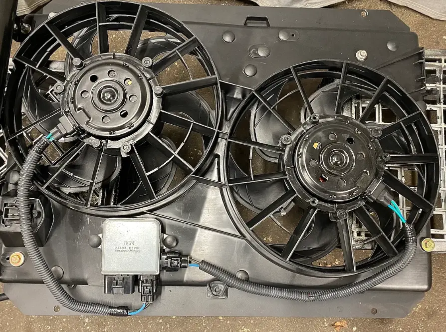

I run my contour fans with this. I bought a used one though for $15. It works with MS3 as i've tested it and will be using it with mine. I used it by creating a PWM output based on coolant. However the new MS firmware due later this year incorporates PWM as an output in the fan control menu so you can dial in things like fan off above a certain speed, and AC idle up.
Reactions: General karthief
POS and NEG into the module. One single PWM wire back to the ECU for the signal. 2 wires to each fan.
Yes, all the pigtails are available online. Module and fans
