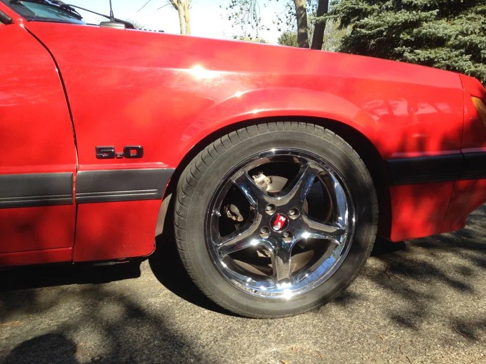

Hey I wanted to know how good(ride wise) these coil over springs were and how low they could be able to lower the car. Also where can I get the coil over sleeve or what can I use as the coil over sleeve?
Not exactly sure on your specific kit but you should be able to lower them to the point of tire/fender/inner wheelwell contact. This is as low as I would set mine before issues with 14"-150# MM kit & 245/45-17 tires. Also are those QA1's 110#? If so they are to soft for a street car.

I don't want that low tbh I just want to close that gap between the wheel and the fender and hoping that helps with the cars handling because its body roll is insane and spins out quite often. I was thinking it might be the tires so I'll be changing those out also...Might even change out the whose suspension set up if I have the money and I need to XD

Lowering the car will not solve a condition where the rubber bushings that keep the suspension centered are badly deteriorated and sloppy. 14/110 springs are drag springs,....and will not support the weight of the car. Most coil overs on the front of most street driven fox cars are 14-150-14-175#'s or greater.
