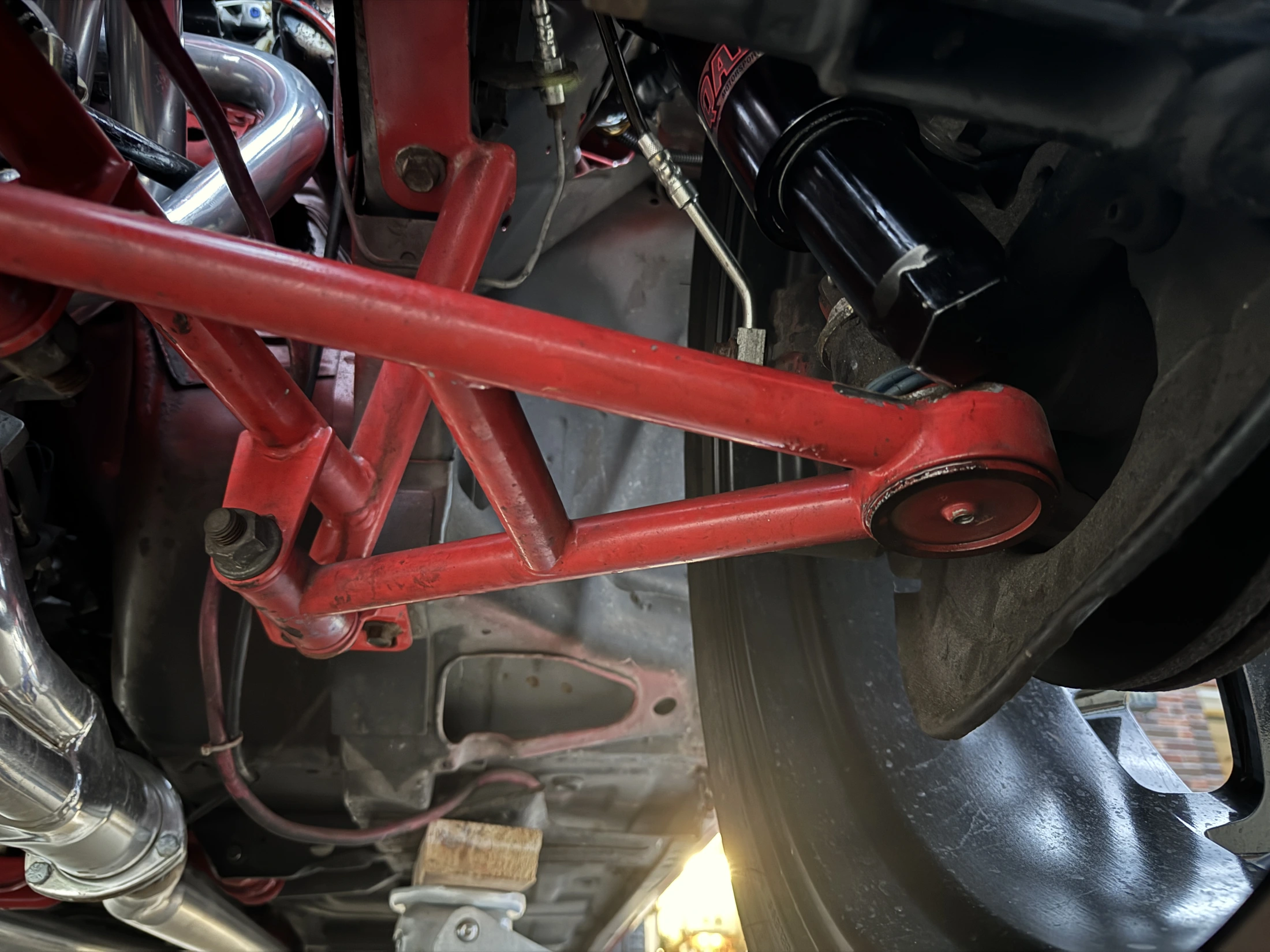

QA1 coilovers are rubbing/hitting control arms. How to fix?
Do I have the wrong control arms? Any way to adjust the struts? For context, I did not build the car. Working backwards on a brand new built car

I would try loosening the lower mount bolts and let the suspension weight try an pull it down. There might be some slop in the bolt holes.
You might also find a tiny bit of room in the K-member mount bolts.
Does it do the same thing on both sides?

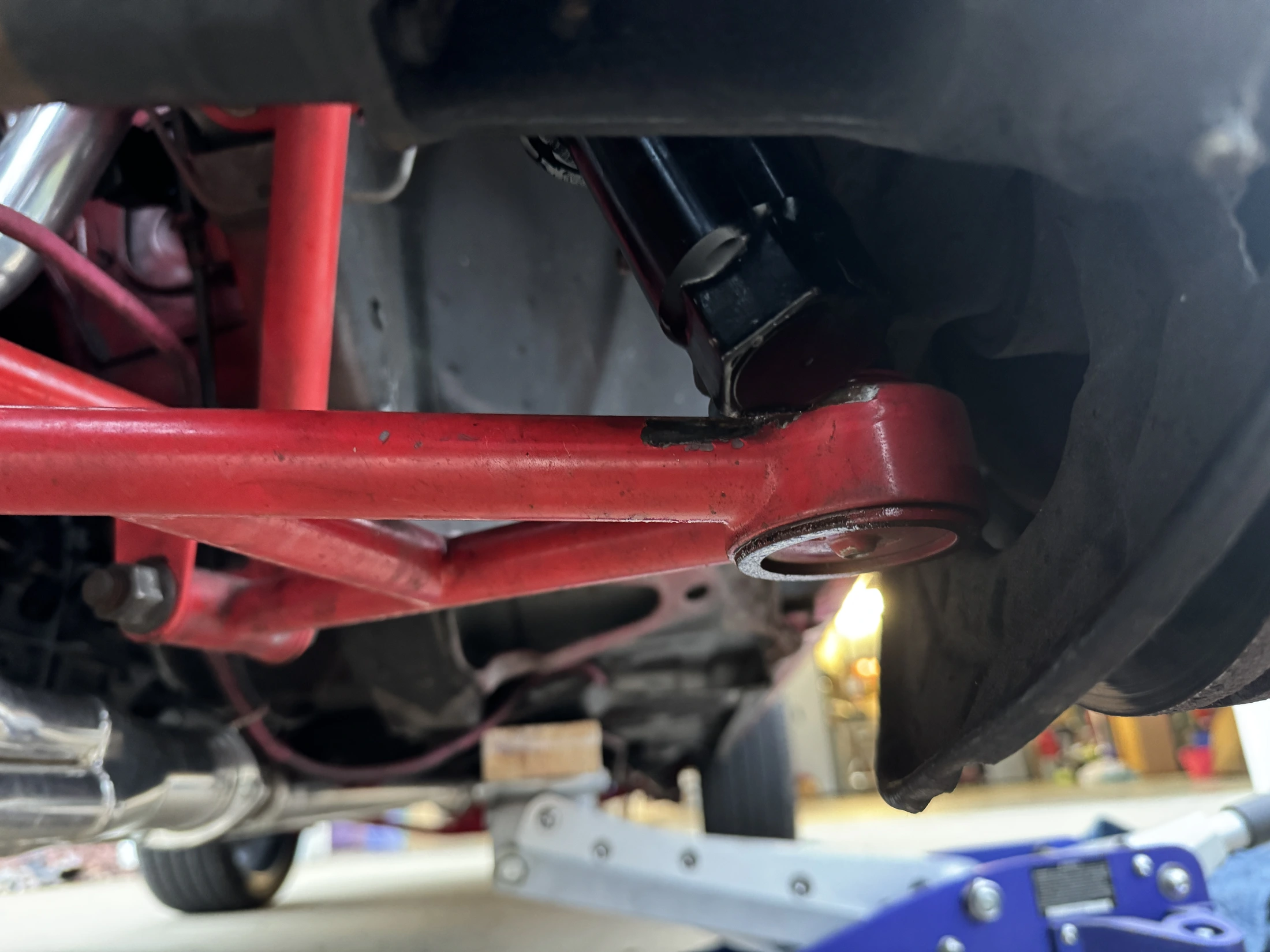

Yes. I’m not too sure what K member or control arms are on it yet. But I’m suspecting the control arm is the problem. I’m not sure if there’s any way to get the strut to sit higher so it will clear. Took the wheel off and adjusted the spring, but I need the lower part of the strut to sit higher

So it looks like the control arms have Fox ball joints and SN95 spindles. I am only guessing this due to the washer stack on the top of the spindle and below the castle but if the ball joint. Depending on how it was all designed this could cause an issue.

Those struts are awfully long below the spindle mount bolts. Best and easiest answer would be different struts. Most struts stop just below the lower spindle mount bolt.

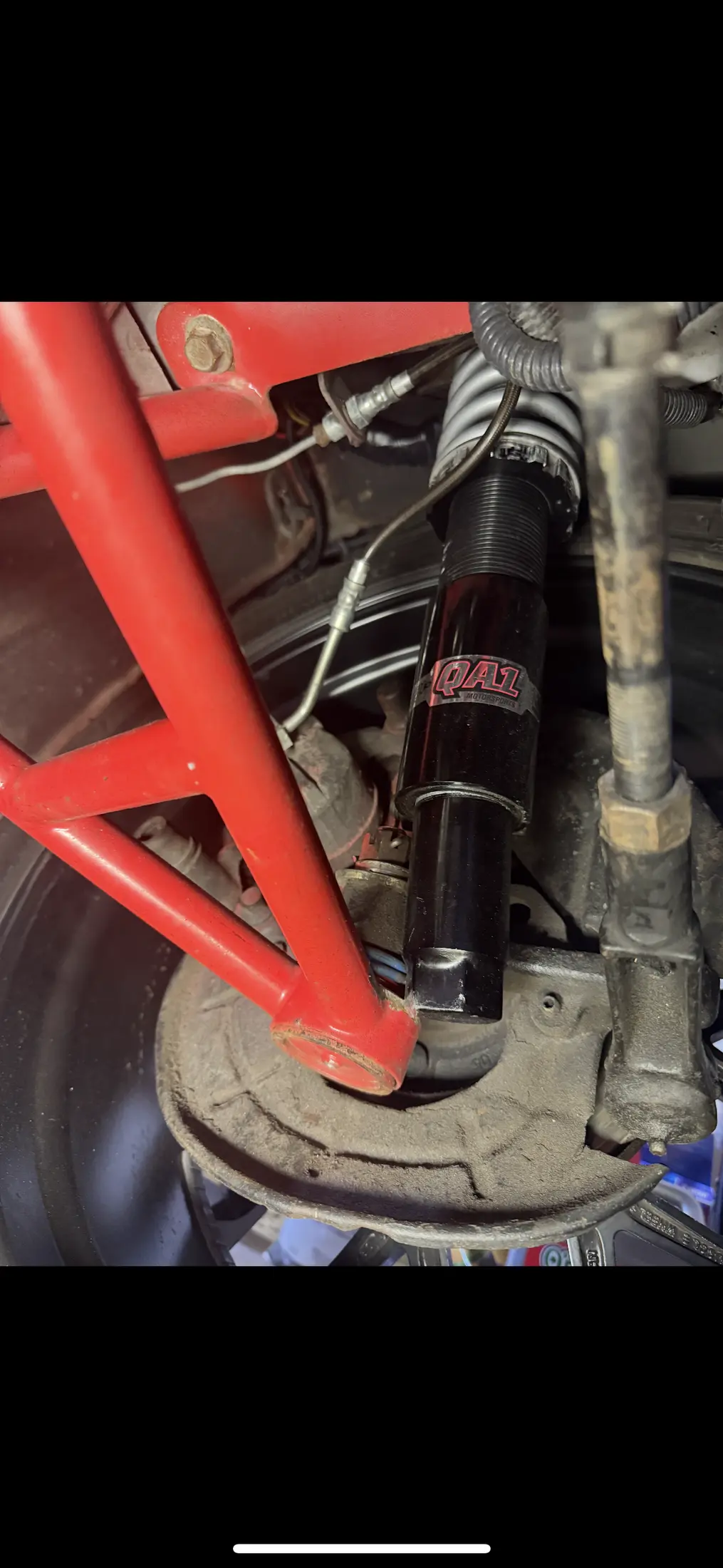

Does this image help? It may be the wrong struts. It almost looks like the struts could go up in the boot/collar but it’s crooked.

That looks horrible man. Like, dangerously horrible.
I think @KRUISR hit the nail on the head.

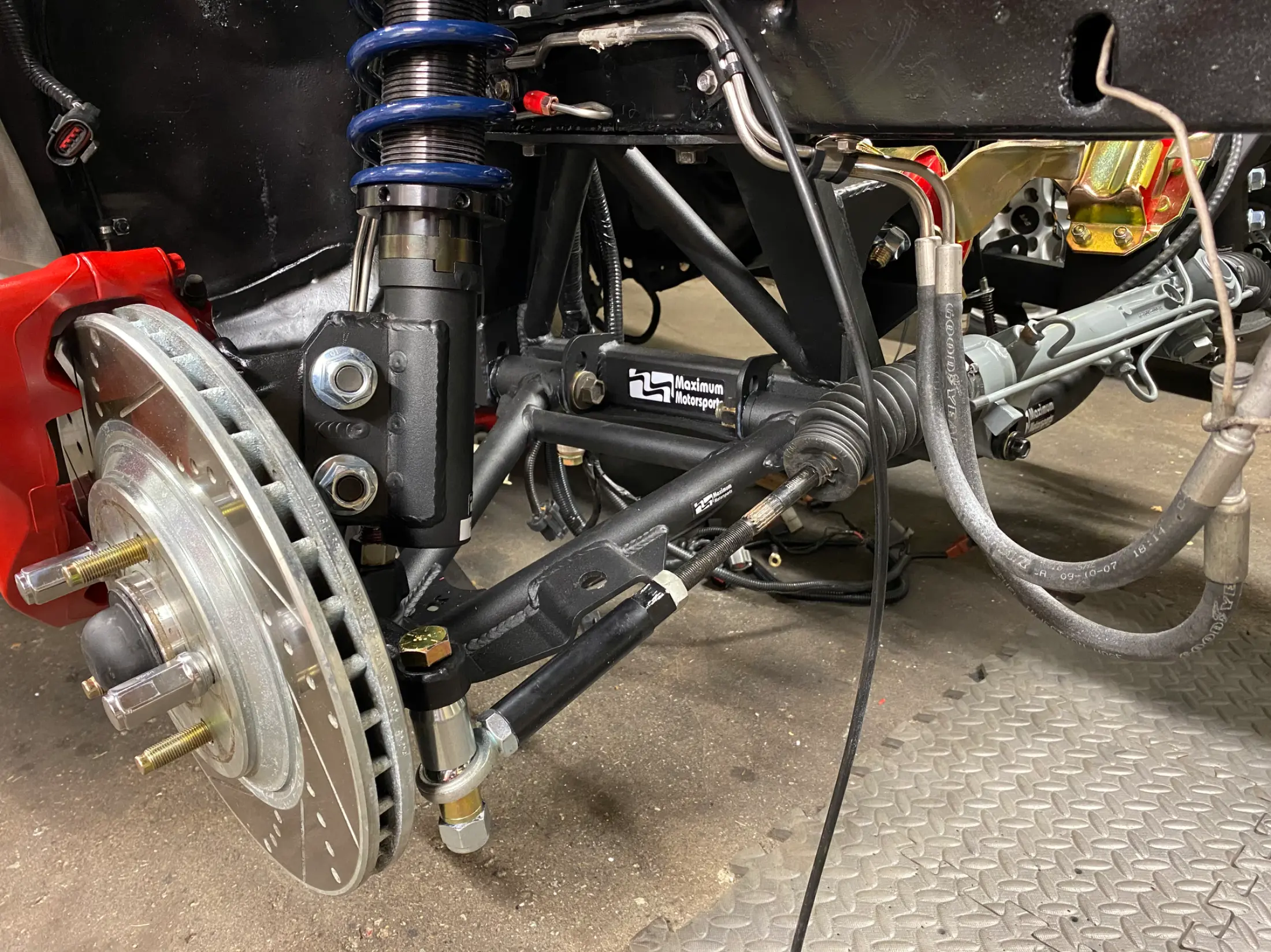

I'm with @KRUISR here. Those strut bodies are way too low. It's like the collar is slipping.
Different angle I know but this is how mine sits on MM stuff. Body is way higher

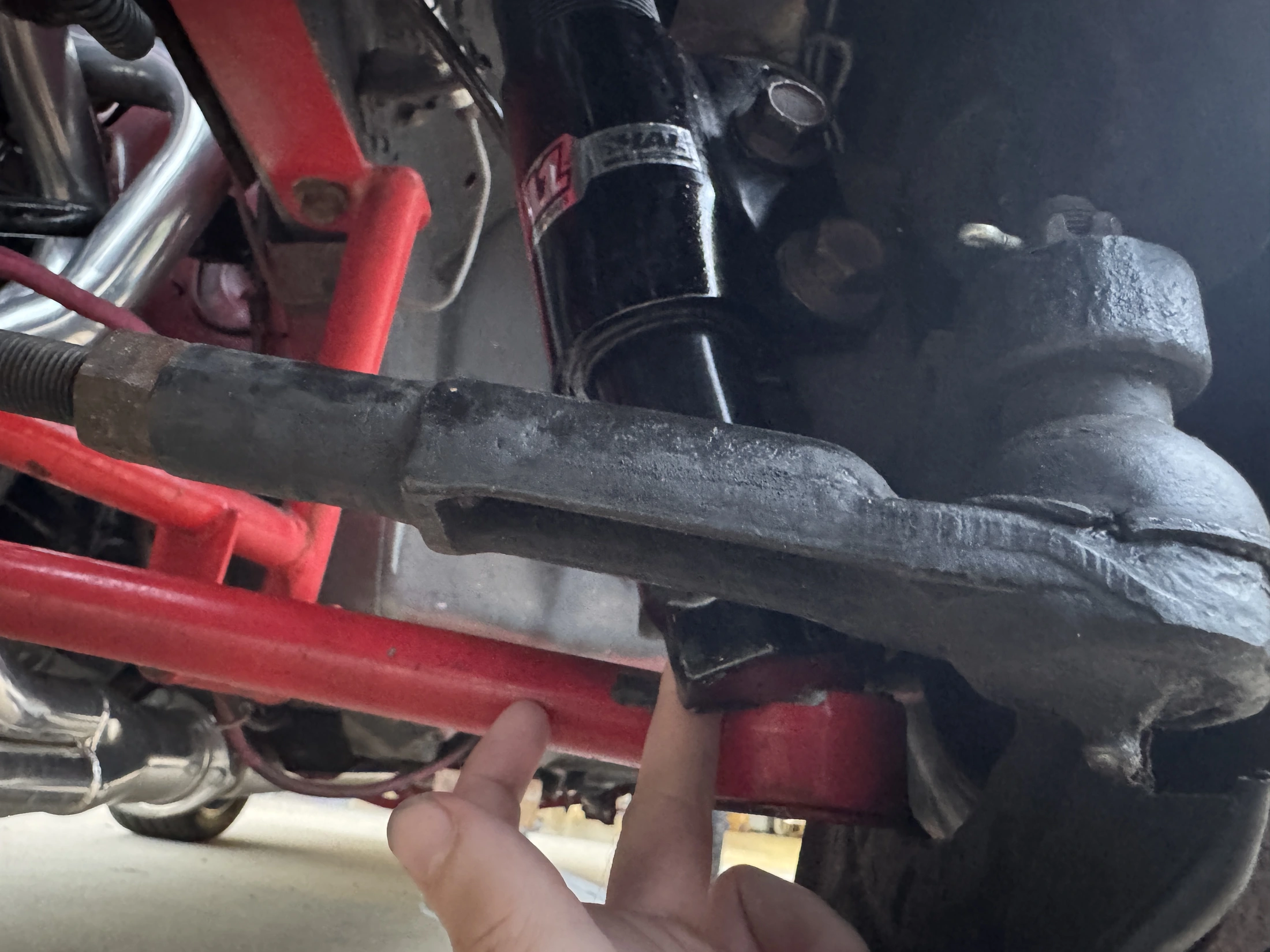

Yeah I tried moving the collar down and doesn’t seem to want to go. It’s possible the guy who did this used the wrong struts.
My question is, what is the best & most cost effective fix? Use the same spring on a new strut? Or a whole new kit?

Pull the wheel and the strut. If I am not mistaken it looks like the spindle mount section may be threaded on. You might be able to spin the mount closer to the end of the strut, probably can't go too far but 1-1.5" might solve your problem. The hex head on the bottom of the strut and what looks like a thread coming out from the spindle mount bracket. You will then need to adjust your lower spring perch lower as well to maintain your current ride height.
If you can't adjust, you will need new struts. The springs should be fine on any coilover strut.

I’m convinced the collar can move down. But I’ve spun it a few times and it’s not gaining any space.
