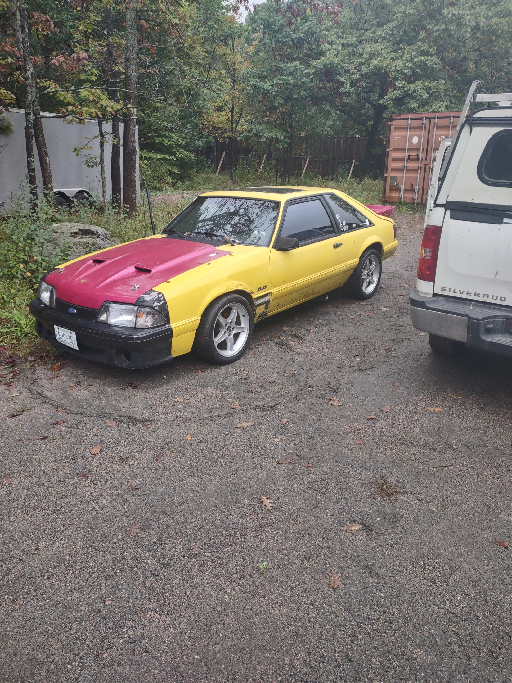

Looking for suggestions on control arms and possibly adjustable ride height shocks. I'm having trouble with rubbing on control arms when sharp turning. Car has brand new springs but would like to replace stock shocks and would like to get something adjusted for the front at least. Ride height or stiffness or hopefully both.

The wheels do look like they a restocking out a bit more then my five lug wheels on mine.
What spindles were used? I used 1994 spindles with 13 inch rotors and pbr twin piston Calipers, I don't have your issues.

10mm spacers on the car now and everything else is stock except for the rotors are a cheap slotted and drilled pair. The 5 bolt kit I just got off another car I bought for parts but I didn't change the spindles.
Looks to me like a wheel size/offset issue, you need rack limiters
Thanks. I've mostly had 1980-96 Ford trucks in the past so I don't know alot about rack and pinion steering. I was wondering about how to hook up some sort of stopper to keep from hitting. I'm also hitting the tire's with the front fenders a bit so I'm also looking for recommendations on adjustable shocks.

I am gonna go out on a limb here but I think you have to have the SN95 front brakes to fit the Cobra R replica type wheels. If they are OEM FoMoCo R's for a 1995 then they will work and if they are the real ones I would sell them and fund a SN95 brake swap on the car. The hubs are too large on any of the Fox rotors to fit SN95 wheels with the exception of the wheels listed in this thread:

Calipers are job stock replacement from the 4 bolt. I got them before switching to 5 lug. The rotors and rear axle shafts are off a parts car I got and don't have any information on them

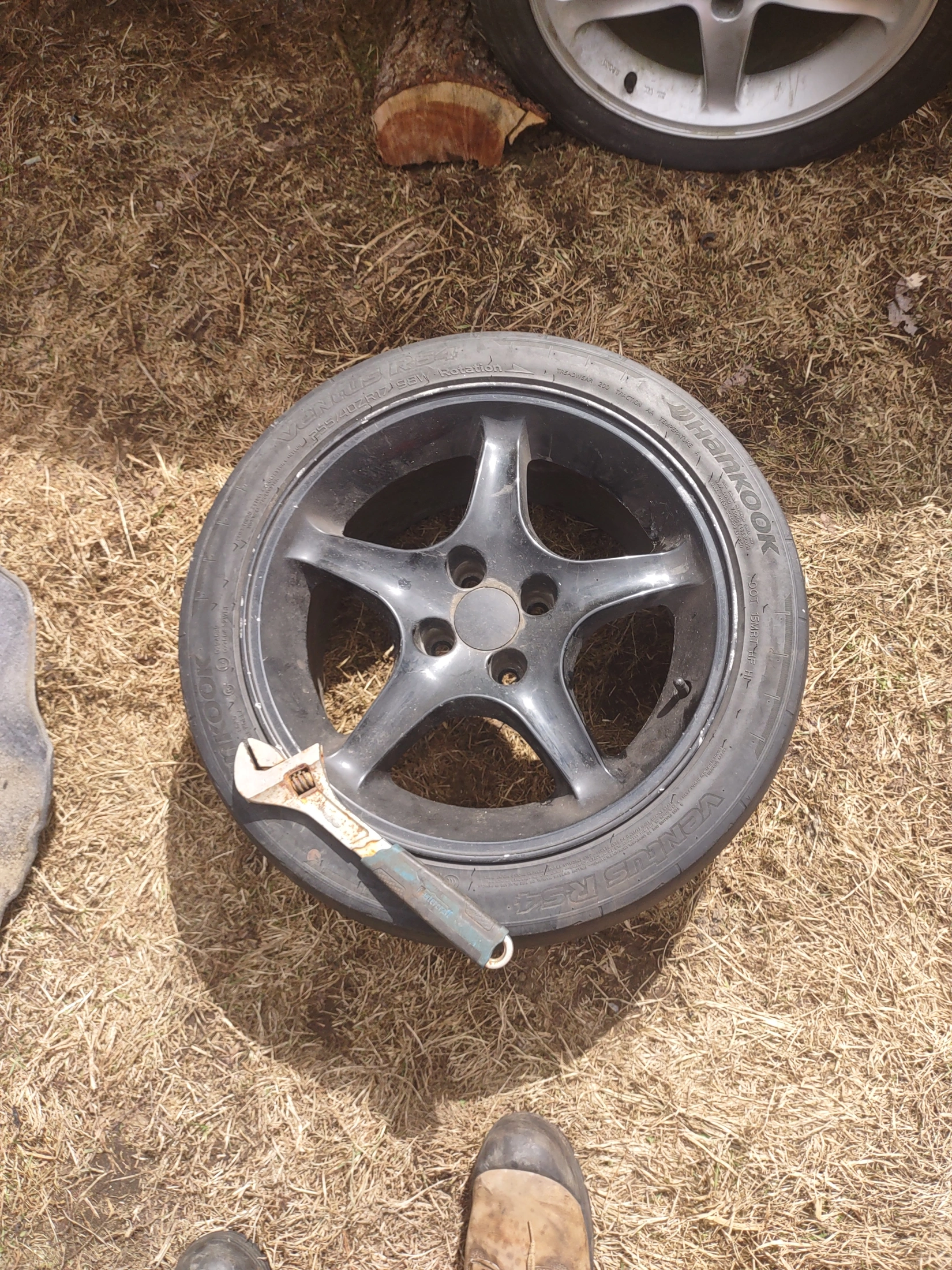

275/35r17
On the front? That would be a big part of your problem right there. That is a very wide tire for the front. I have only seen them on the front of a foxbody before with large flares on the fenders to move the tire further out to not have rub issues.
What is the offset or backspace of your rims?
I'm not sure the backspacing. They seem the exact same as the 4 bolt rims that where on the car when I got it witch always rubbed when turning sharp. I do want to lift the front a little to help with hitting the fenders but my biggest concern is hitting the control arms. I did put on 10mm spacers to make a little more room.
