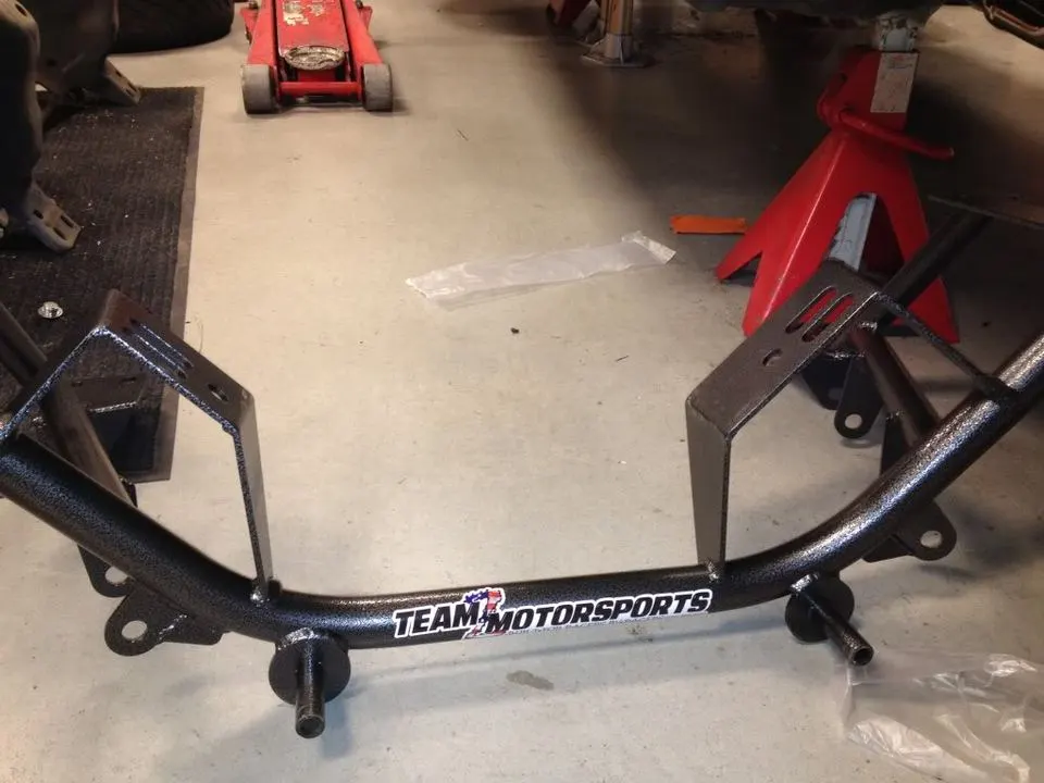

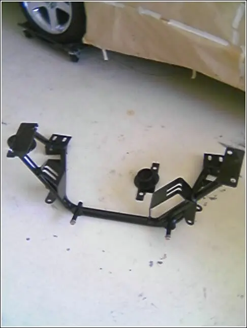

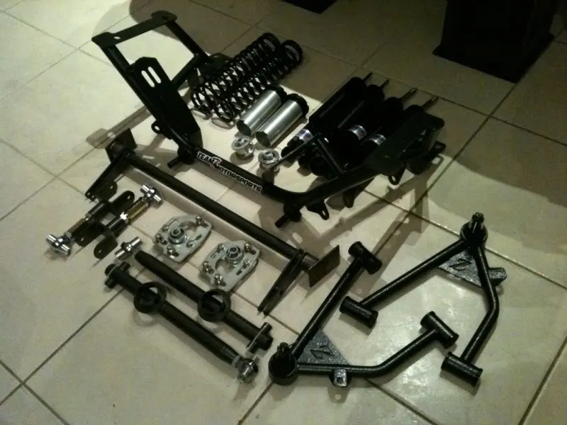

The QA1 will alter the suspension geometry. I believe it moves the front tires back 1" and lower the car half inch. People should know that going in and I don't remember a tag saying that it does when I got mine. Also its the thinnest K-Member made. My experience with TeamZ's K-member is that's its gorgeous (see pic below).
Here is the QA1 for my 94GT.

Here is the TeamZ complete front and rear suspension for a FOX body.

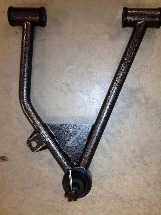

I did my k member with my new build. My builder had a couple k members laying around, a PA Racng and a UPR one. I ended up going with the Team Z one, and I wont look back. Looking at the quality after I got it, I was impressed. I also pulled out the scales (not bathroom scales either) and the Team Z was 2-5 lbs lighter than the others we weighed.
