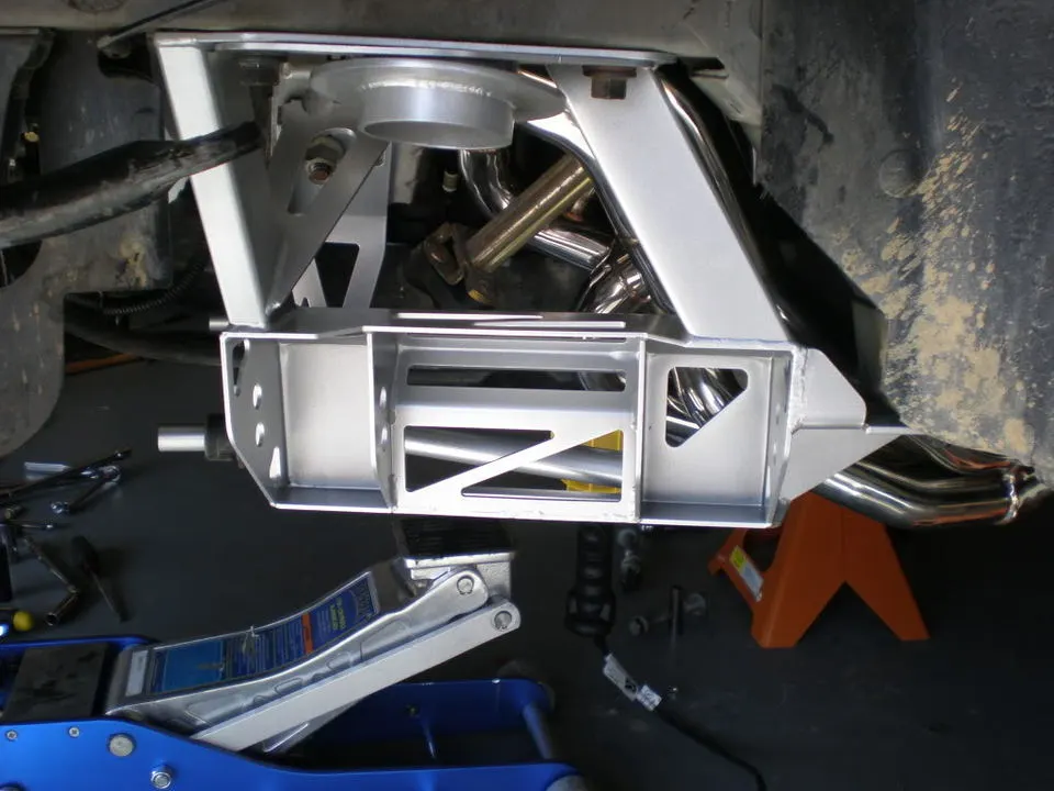

Here is a pic of the spring perch up top

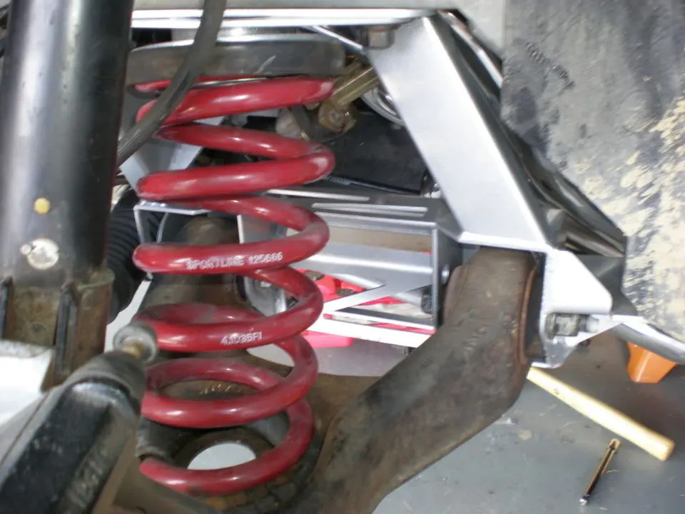

Here is a pic of the spring in the a-arm and in the perch.
according to QA1 the proper fix is to run a shorter control arm. They said to install a coil over set up to fix it the way it was meant to be. Then they said if you run a foxbody control arm with a 96-04 ball joint that will work also.
