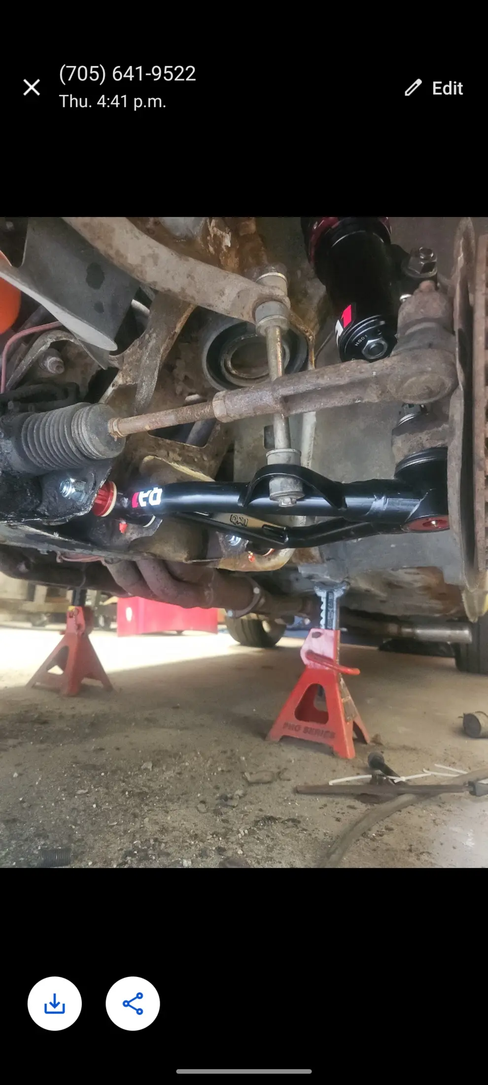

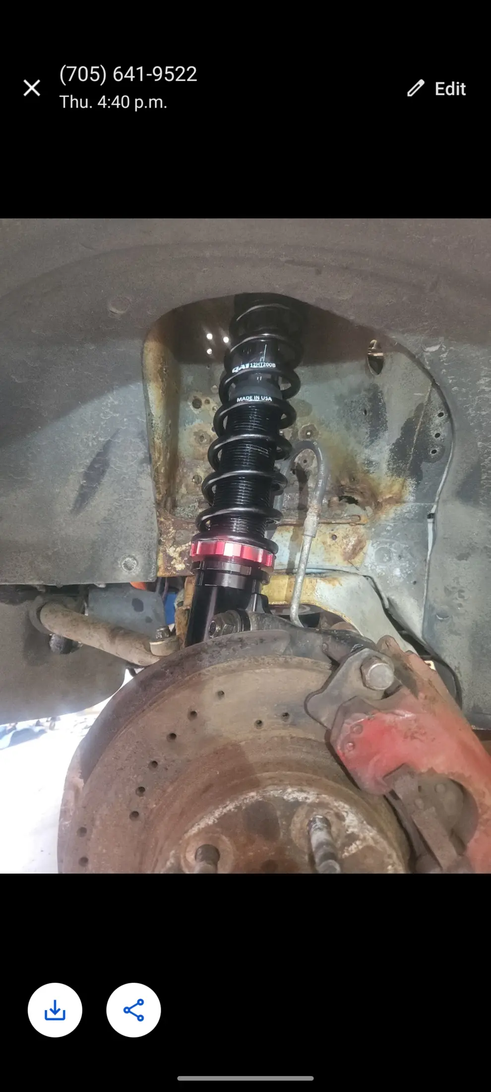

I have upgraded with QA1 adjustable coil over struts and the adjustable control arms and now I'm looking to upgrade the rack and pinion and was wondering about using the manual steering 20-1 steering. Just wondering if anyone has experience with using the manual steering set-up on a daily driver
