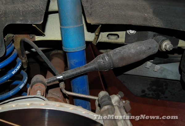

first off, does anyone have any good pics of what the quads would look like and where i can find them on my 01 gt? i tried searching but couldnt really find any good pics...
i honostly think that the quads where taken off my car... i currently have the mm coil overs, but i am wondering what actuall effects the quads would have on the handling of the car supposing i dont have the quads in right now? i know that mm says they help position the axle... but what actual handling effects would be gained once i install my mm lca's which dont require the stock quads...?

The black unit in the pic:
If you don't have them in, you don't need them once you install the MM units.

wow... thanks alot sanman!! i really appreciate ur help!
yea i definately do not have them in my car now, i thought they would look similar to that in the pic...

san~man said:
Because you don't have the quad shocks, you can remove the quad shock brackets that attach to the frame (upper right part of the picture).

bionic_chronik said:
I'm actually wanting to put a pair of quads on my 91 today. Wheel hop is insane, I've probably already tore my rearend up. Whoever took them off was a moron. Anyway.. sorry for hi-jacking, but is the foxbody quad setup similar to that picture? I know I have the stud coming off the frame where you bolt the top of the quad to, but what does it connect to down below? somewhere around the drum or what? I don't remember seeing anything it could bolt to down there. Anyone know? mustang5L5, do you know? seeing as you have a fox with the quads still on?
The quad shock setup is the same on the Fox as it is with the newer cars. The above picture would apply to you as well.
The quad mounts to the top of the axle. There will be a flange right behind the drum. If you look at the pic you will see it.
That's assuming you have an 8.8 mustang axle in your car. The 7.5" did not come with quads, so it doe not have this mount.
Autozone sells a Gabriel replacement quad shock. It's listed under "steering dampener" Part number 14039. They are $25 each, but i think you need to buy them online.
