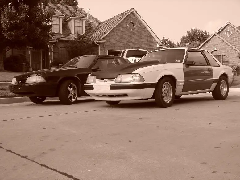

i kept them up front in my old coupe when i did a v8 swap into it. here's a pic of how it sat. no a/c, no smog, no sway bar, factory k member. oh and mine is the multi colored one. lol. and to do a comparison, the black one has factory v8 springs.
