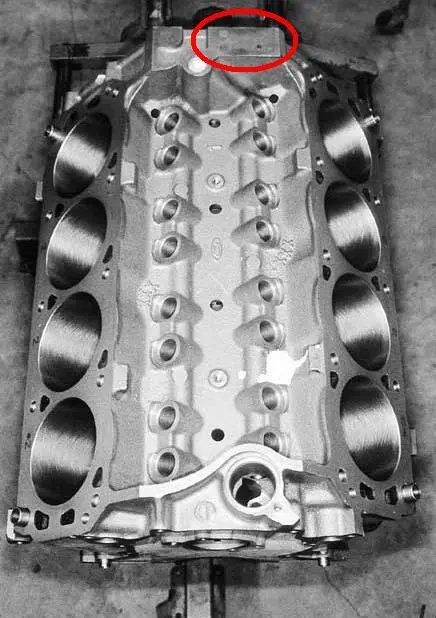

Alright where are the block numbers located? So if it's not the HO the firing order is different. and I just checked that when reinstalling it and i timed it off the HO firing order. I'm just assuming the engine is from a later model fox due to the mechanical fuel pump being on it.
