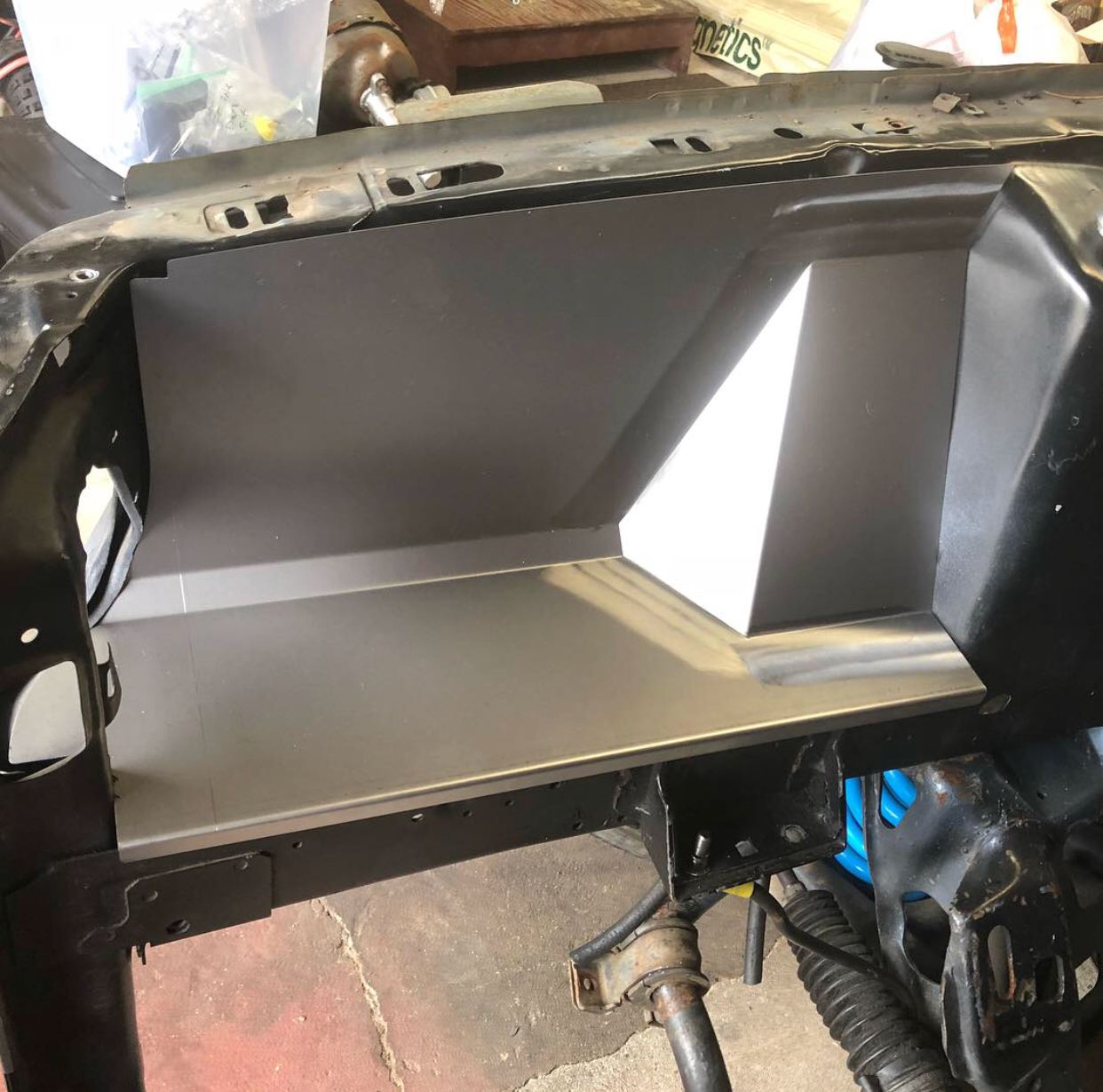

Just did a set of inner fenders, didn’t do towers but there’s no way they overlap, the fender covers go right into the corners.

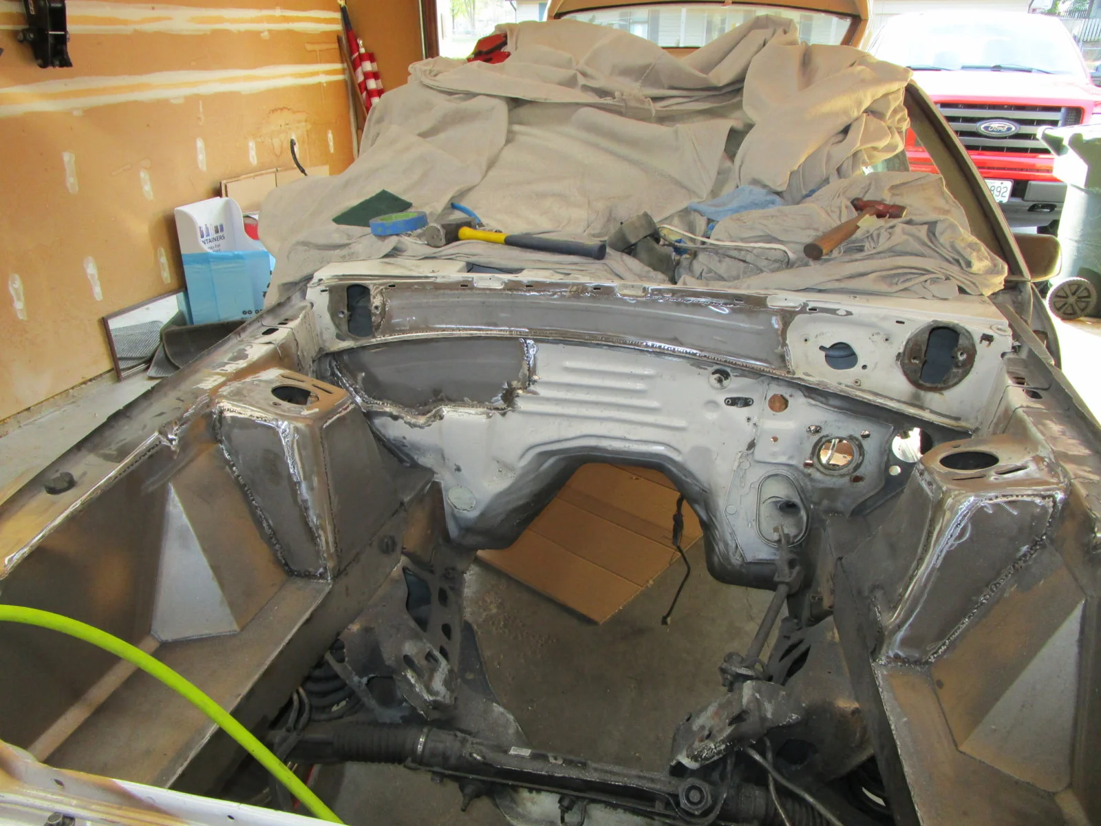

I just welded up the holes in the shock towers. So I'm not sure about the overlap of those panels. I really didn't see the need for the tower panels.
