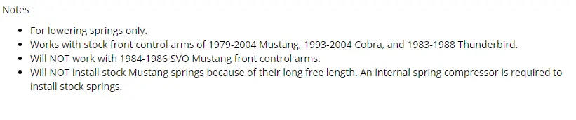

Has anyone tried to install stock springs with the MM install tool??
They say specifically on their site the tool will not work with stock springs.
F it.... lowering spring time. I'm not gonna fight with stock springs. Now i need to pick up the MM tool without dropping $50 on it for the tool plus shipping.

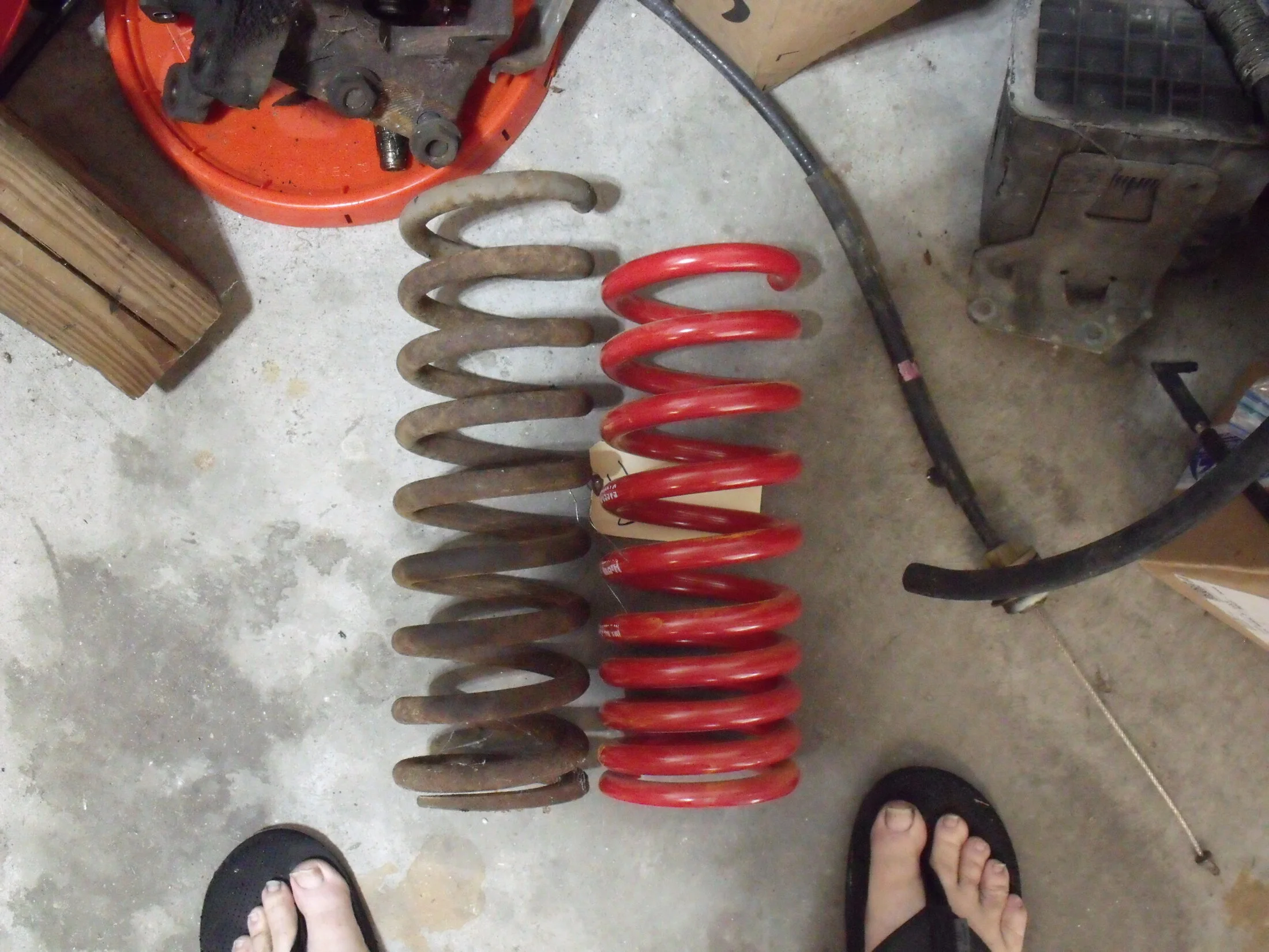

My C springs went into the perch by hand. Very easy. The Bullitt springs were longer so I had to get hose clamps to take up some of the free lenght to get them in. I like the idea of this tool because it gives me a “ramp” to help kick the spring into place. We will see.
Ideally I’d like to get the OEM new edge springs back in as I’d hate to put stiffer lowering springs in with stock 20+ year old struts. I imagine it will ride like a dump truck. I might have to get some hose clamps and see if this tool helps to get them back in. I know…hose clamps aren’t exactly safe but if you strap 10 of them on it does the trick
