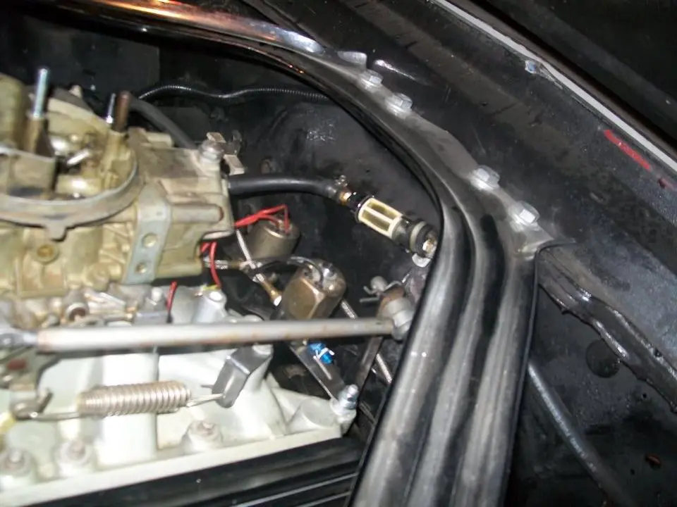

Where did you mount your solenoids? Any pics?
I mounted mine today, but I'm not sure if it's a good place for them or not. I'm just not sure what to think about where they are.

Post a pic. If they don't interfere or close to to heat they should be fine. I like short metal lines myself.

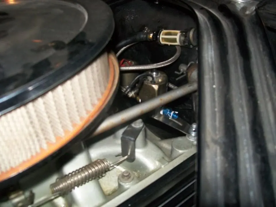

I'll post one tomorrow.
I took the back intake bolt off each side and replaced them with studs like on the late model 5.0's. Then I just slid the brackets on the studs and put another nut on it. The brackets go in toward each other, so they are right next to each other right behind the carb.
I didn't really want to clutter another area of my engine bay, or drill holes in the aprons or firewall. So that was a good solution that kept me from doing that. No drilling, and they are somewhat out of sight. I'm not trying to hide them, I just didn't want them to stand out.

They may be too close to heat.

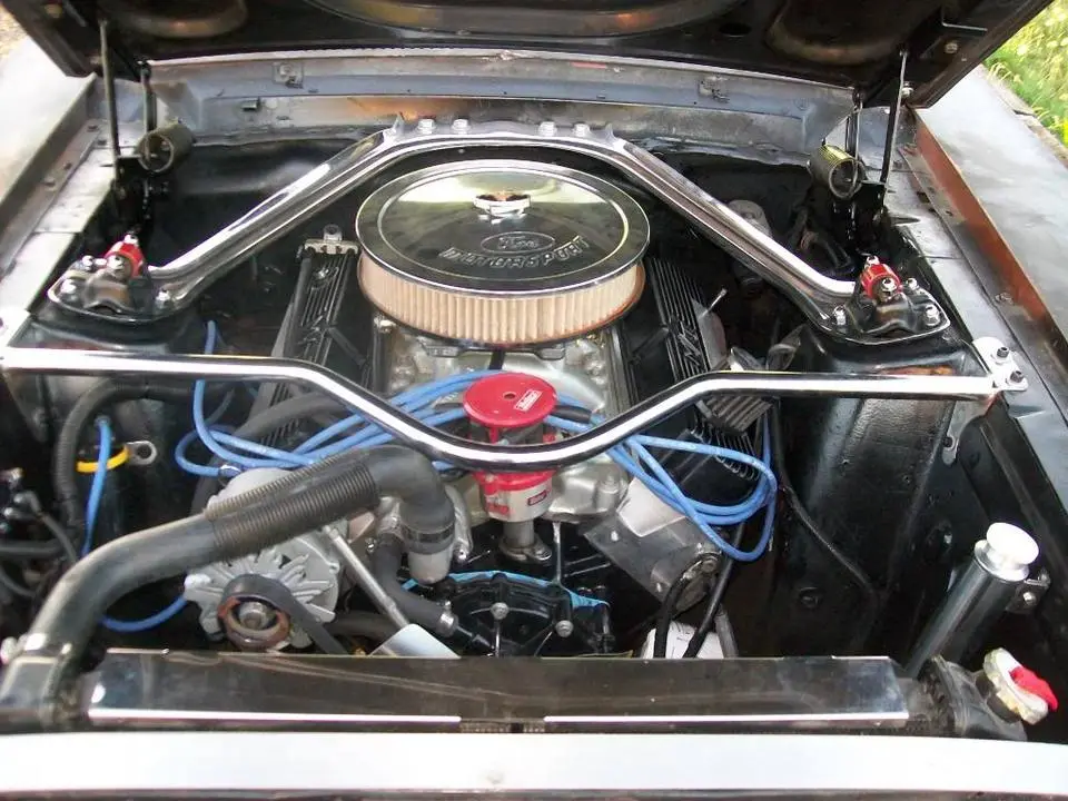

Here's the whole bay, if it gives you any ideas.

Are you trying to hide them??
I had mine mounted on the front carb studs

Not really, I just wanted them out of the way, where they weren't really that noticeable. I didn't want to clutter up an easily seen part of the bay.
I thought about hiding them, mounting them on the inside of the firewall, and putting the bottle between the back seat and the front trunk panel I made. But you would still be able to see the plate and the lines going to it.
