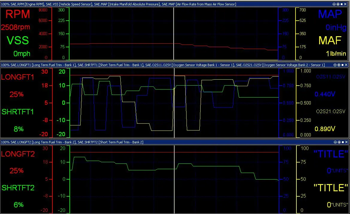

Your LTFT are off the charts on both banks. Since there isn't a real difference between idle and load, IMO that lowers the likely hood of this being a vacuum leak. Instead the focus should be on a cause common to both banks. For example:

Suggest monitor the MAF flow and confirm that it changes. Also monitor the fuel pressure with the ODB2 scanner. Verify that it changes some with motor load. Cross check the PCM fuel pressure to an external gauge (disconnect and plug the FRPS intake vacuum line for this test).

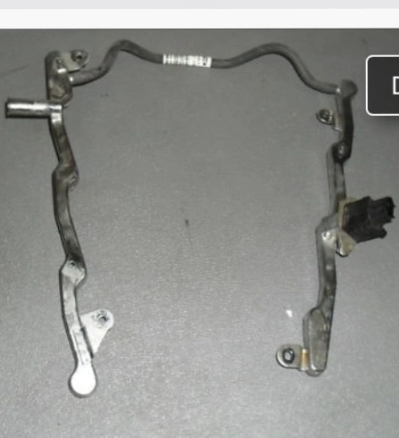

Okay so seems ford did away with the fuel rail mounted schrader valve sometime in 2003. What's the procedure for checking fuel pressure on these cars? Seems I'll need to buy an adaptor of some sort?
