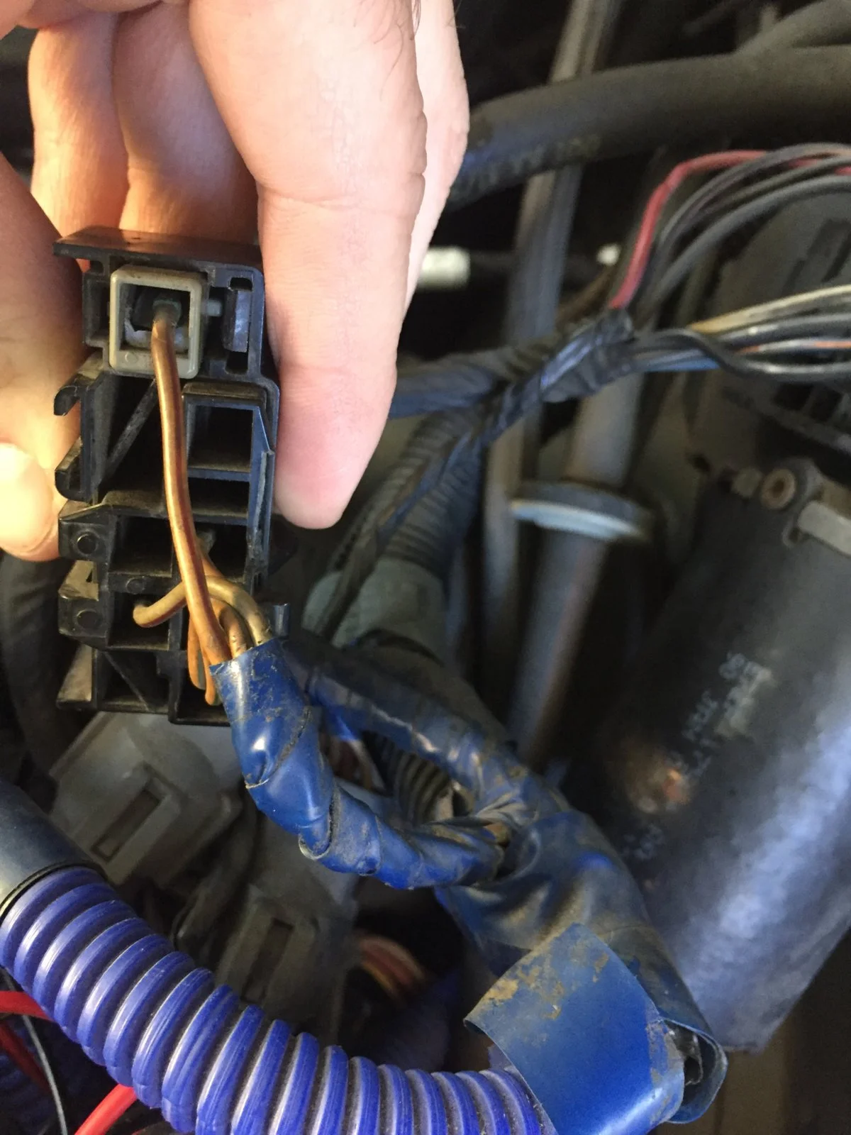

Hello, this is my first post. I purchased a 1990 GT and I was planning on using the OBD1 scanner for my irratic idle then go off the surge checklist. My problem is that there are already wires going into the EEC test where I connect the scanner. Has anyone seen this before?

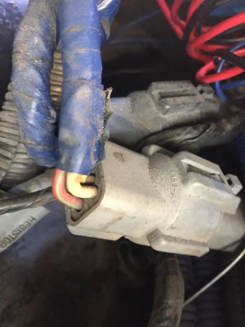

Hi, Thanks for the reply. The first pic is the EEC with the wires already connected. The second are where they are wrapped and then slit off into the firewall. I hope this helps a little.

The first picture is the test wires. Pull the cover off (or pull the connector out of the cover) and that is where the scanner connects. The part you are holding in your left hand is simply a cover that holds the connector when not in use. The small single wire also pulls out, it is the fuel pump test wire that also connects to the scanner.
