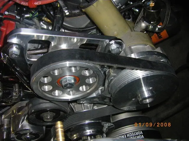

I just completed putting a Vortech supercharger on my 5.0 engine in my 68. I have a unique combination of PS and AC brackets. I already invested in a March PS bracket but wanted to leave myself the option of adding AC later. I kept the march bracket and modified an original 5.0 AC bracket. I basically gut the PS portion off and only left enough metal to mount the AC at a later point. I then had to modify the bolts and spacers for my combo. I think it looks good and if you want a picture let me know.
Here you go.
