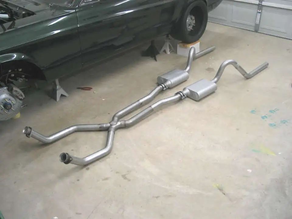

This is JBA shorties, Dr. Gas X Pipe, Delta 40 Flowmasters, Flowmaster tailpipes...all 2 1/2". I tacked it all together under the car then pulled it out and had it tigged.
I had a local shop do up a couple of bends for me. A couple of welds and presto. H-Pipe. I will finish it up tomorrow and post some picks. No mods to the seat pan plate. All tucked up in the tunnel nice and neat.
Horrendous amount of work but worth it.

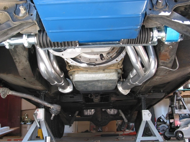

The problem is not so much with the belly-plate, but the width of the pan. Here's a picture of the LTHs in my vert:
I took it to the exhaust guy and he talked me into shorty headers, the problem was making the bends from the collectors around the (Windsor-Fox Engineering) AOD mount and back into the tunnel above the belly-plate. He said he could do it but it would be fugly, restrictive, and toast on the first speedbump...like I said...he talked me into a set of shorties.
(note in that picture I still have the factory C-Code drivehsaft and 8")

Ouch that Fuel Line is a tad bit close to the exhaust.... dont you think?:eek:
