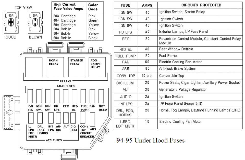

I am in Michigan and I left my manual at home.....I need to know what the 50 amp fuse under the hood goes to...it is the 4 th Maxifuse from the intake........there are 3 40 amps in front of it. Please help.....
Thanks
Will
Courtesy of S&2B's (site host) and the aforementioned Tom Moss (author):
