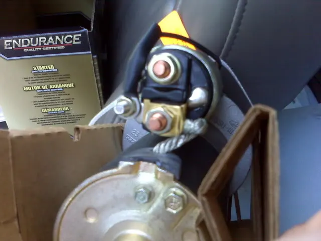

I'm assuming (since there were no instructions included with the starter) that the attached lead on the left is the ignition switched power in, the top big lug is the battery cable in, and the bottom big lug is the ground? Is that correct?
It is a mini starter for 93 Ford 5.0 with 157 tooth flywheel.
Thanks a lot guys.
No. Mini starters get the battery voltage full time on the large cable (top terminal)
The smaller terminal on the left gets voltage from a relay or as most retrofit kits use, the existing solenoid to pass the "start" voltage.
The bottom large terminal is not ground. It is the power that is going to the starter windings. There should be no connection here.
Ground is accomplished through the engine block.
Here is a thread on wiring mini-starters.
If you can maybe get a better picture from a higher angle so I can see the terminals better?

Thanks man, glad I asked, that could have been interesting. I've actually already bookmarked the link you gave me, thanks! You convinced me to run the fender solenoid or relay instead of straight to the starter's solenoid.
Here are some more pictures. The Crack Berry camera isn't working so hot today...
