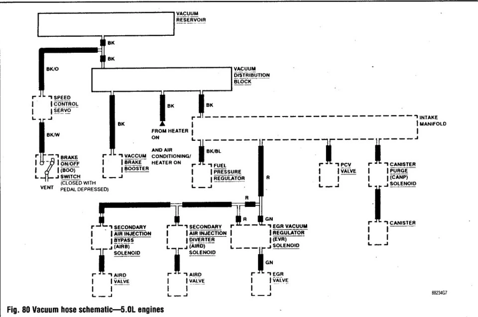

95Cobra302 Founding Member Apr 9, 2002 394 3 19 Daytona Beach, FL Jun 6, 2006 #1 Jun 6, 2006 #1 Near the back of upper intake we have 2 vaccum lines red and green. Which one goes to the EGR valve and which goes to the upper intake???
bill302 Active Member Nov 2, 2005 2,131 1 46 alabama,gadsden Jun 6, 2006 #2 Jun 6, 2006 #2 red to the upper intake and green to the egr valve.... Attachments vacuumschematic.webp 52.1 KB · Views: 131

bill302 Active Member Nov 2, 2005 2,131 1 46 alabama,gadsden Jun 6, 2006 #5 Jun 6, 2006 #5 eades5.0 said: great diagram Click to expand... thanks to my chilton manual and a scanner....but thank you eades5.0...
