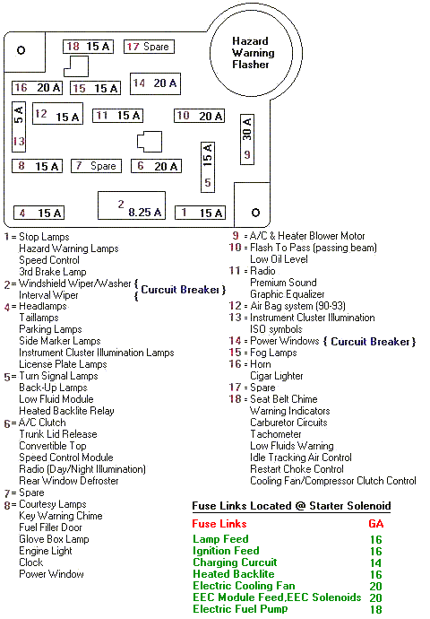

Black Sun 5.0 Founding Member Mar 23, 2002 1,337 0 36 L.I., N.Y. Oct 6, 2008 #1 Oct 6, 2008 #1 I have no heater fan, it appears to be dead. Does anyone know which fuse or relay I'd be looking for to resolve this?
jrichker StangNet's favorite TOOL In Remembrance. Thank you for your contributions Mar 10, 2000 27,512 2,813 234 Dublin GA Oct 6, 2008 #2 Oct 6, 2008 #2 Diagram courtesy of Tmoss & Stang&2birds See the following website for some help from Tmoss (diagram designer) & Stang&2Birds (website host) for help on 88-95 wiring Mustang FAQ - Engine Information Everyone should bookmark this site. Ignition switch wiring http://www.veryuseful.com/mustang/tech/engine/images/IgnitionSwitchWiring.gif Fuel, alternator, A/C and ignition wiring http://www.veryuseful.com/mustang/tech/engine/images/fuel-alt-links-ign-ac.gif Complete computer, actuator & sensor wiring diagram for 88-91 Mass Air Mustangs http://www.veryuseful.com/mustang/tech/engine/images/88-91_5.0_EEC_Wiring_Diagram.gif Vacuum diagram 89-93 Mustangs http://www.veryuseful.com/mustang/tech/engine/images/mustangFoxFordVacuumDiagram.jpg HVAC vacuum diagram http://www.veryuseful.com/mustang/tech/engine/images/Mustang_AC_heat_vacuum_controls.gif TFI module differences & pinout http://www.veryuseful.com/mustang/tech/engine/images/TFI_5.0_comparison.gif Fuse box layout http://www.veryuseful.com/mustang/tech/engine/images/MustangFuseBox.gif Attachments MustangFuseBox.gif 23 KB · Views: 107
Black Sun 5.0 Founding Member Mar 23, 2002 1,337 0 36 L.I., N.Y. Oct 6, 2008 #3 Oct 6, 2008 #3 Perfect, thank you.
