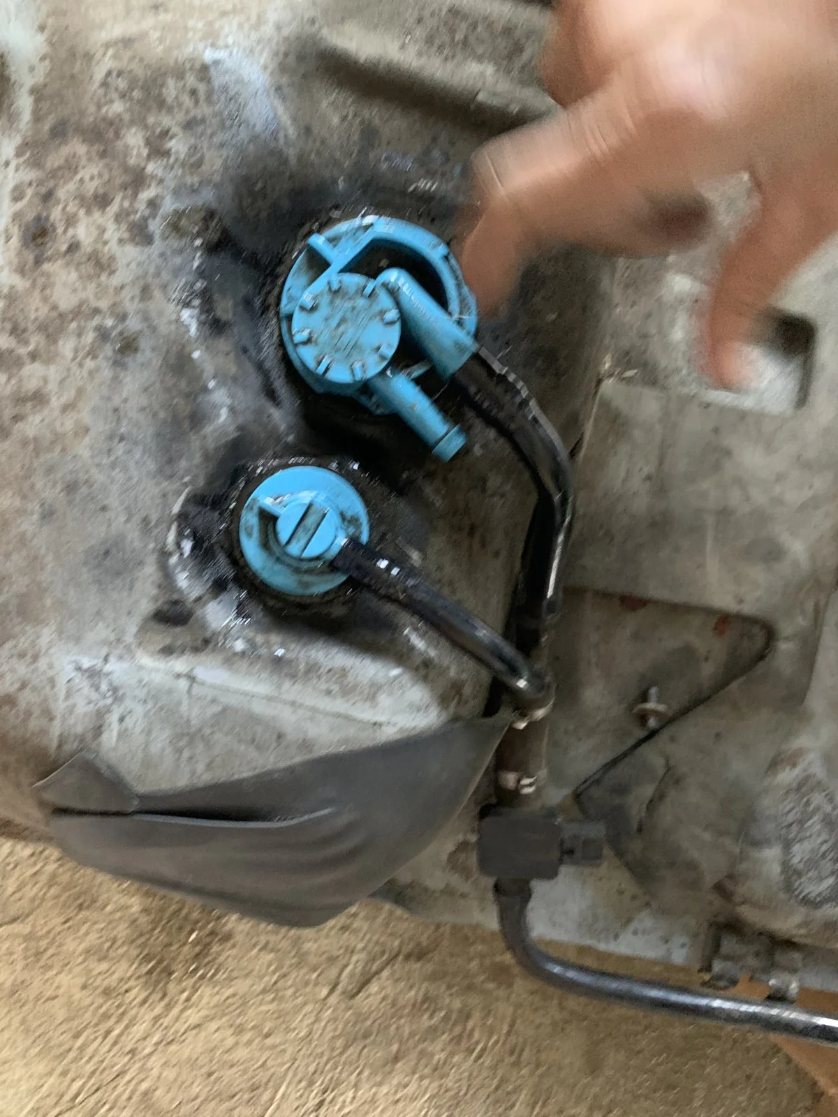

this is my new mustang as well as the valves that didn’t come with the gas tank that took forever to get.

An update if anybody could please help me?
My mechanic said he was frustrated with installing the new gas tank in the car, what tools am I going to need to install the gas tank myself? Also anything I need to know other than plug and play? There is 2 hoses on the side of the tank and 2 valves on top, I have all the parts I need.
My mechanic said the mustang was cursed and I’m starting to think it is, he gave up trying to repair it tonight so it’s in my hands to get it running.

the 2000 GT has 2 different tanks depending on the build date.
Before 12/27/99 Autozone Part#: F52B
After 12/27/99 Autozone Part#: F52D
YES the CobraTank, V6 Tank and GT Tank are the same. Ford is lazy, parts interchange in most of these cars as long as you pay attention to the things that you do. YOU HAVE TO look those part numbers up and see which one that you will need. The build date is on your drivers door jam.
The video that I posted was for general reference on how to drop a tank, the principal is the same for all makes and models. The actual size of bolts may vary. As you remove things on the tank pay attention to what they are and take pictures before removal. On the install, go in reverse order and look at those pictures for the proper connection of the new items.
If you run into a problem, take a picture and post it here so we can help you out. Someone here has most likely done before what you are attempting to do.
The Greatest tool in your inventory is that phone you have. Owners manuals are great but taking that picture of how Ford made the item fit is 10x more acurate for what you are working with everytime.
