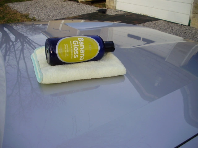

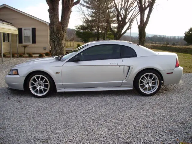

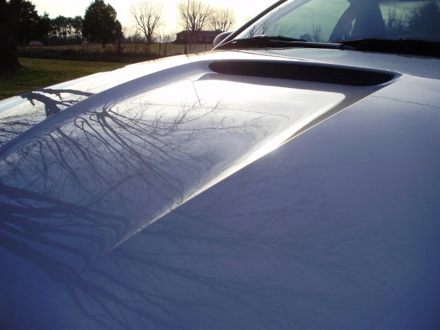

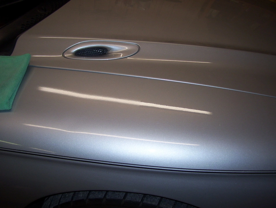

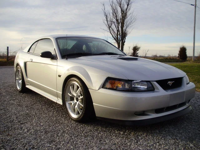

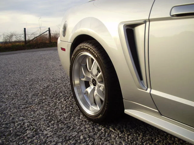

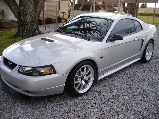

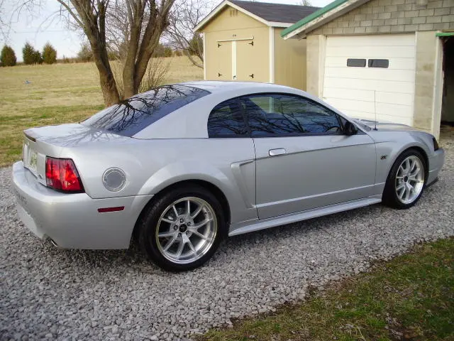

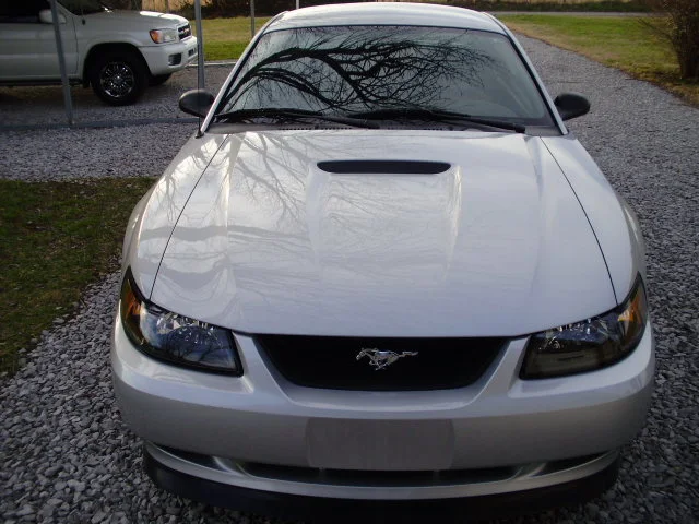

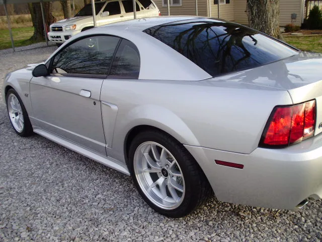

nothing too fancy here. just a wash & wax - a touchup to get me till spring for a full detail. washed the car with a light tri-blend mixture of CG bodywash/wax, CG wash/gloss & 1z einszett exclusiv gloss. wheels were cleaned inside and out with mothers foaming all wheel & tire. tires were glossed with meguiars hot shine. for protection, a coat of prima banana gloss by hand. not the most durable wax but def a neat one. minor concealing abilities along with slight color change in the paintwork. seems to darken & sharpen things up. highly reflective and makes for a super slick finish. wipe on / wipe off and its stupid easy.
Very nice! Those rims are perfect for your car. Are you using 303 on the cowl? Keep up the good work sir!
Only detail I do not like is the rear spoiler delete.
thank you sir - i was actually considering changing up the wheels.....maybe not. always wanted to try 303 but never have. i've been fortunate enough to keep my exterior trim looking clean just from using the good quality soaps. i am , however, a big fan of CG's innerclean on the interior.
Great work man. Once you get a car properly polished its all about the care and maintenance after that :nice:
Car is lookin dead sexy, if I had to add 1 thing to it I would opt for the GT hood scoop but that's it.
you are correct sir. i machine polish the car every year, followed by a glaze and a quality wax. top ups there after about every 4 months or so.
thank you for the compliment :nice:
Looks ridiculous, as always. :nice:

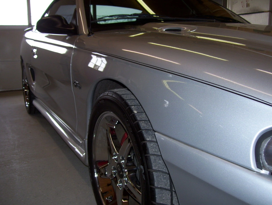

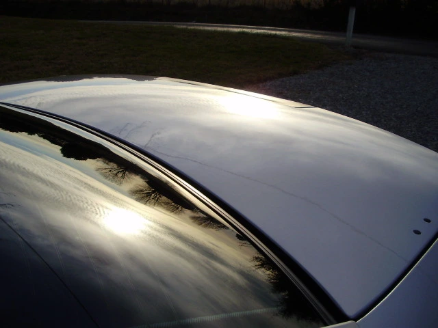

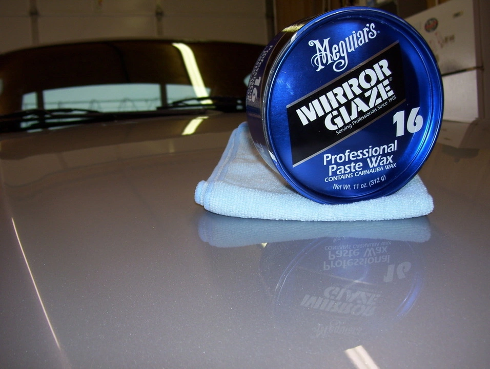

I actually told you wrong; I did take a few pictures on my old point and shoot. Had forgotten to take them off the camera.

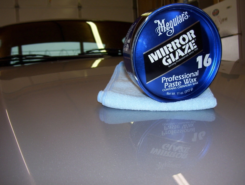

Anyways, here was my process (for the paint anyway).
Meguiar's Deep Crystal car wash (3x strength)
IPA wipe-down
Meguiar's Clay bar
Meguiar's M105 with an orange Lake Country pad
Meguiar's M205 with a white Lake Country pad
Another IPA wipe-down
Meguiar's NXT Tech Wax 2.0 as a sealant with a black Lake Country pad
Meguiar's #16 by hand as the LSP
Overall, I'm very happy with the process. I wish the 105 didn't dust so much, and the #16 could be easier to remove, but overall, it makes the car look amazing. The 105/205 combo is so easy to use, and works wonders on dang near anything (see bottom of this post). The NXT really lasts a while (6+ months easily) and is ridiculously easy to apply and remove. And the #16 is just awesome. I really wanted to try the Autoglym HD that I've been hoarding for a couple of years, but I've just been so satisfied with the #16 that I didn't want to change anything.

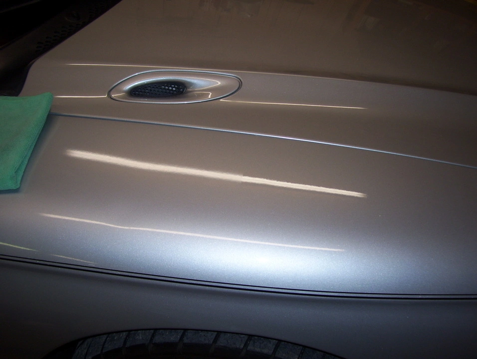

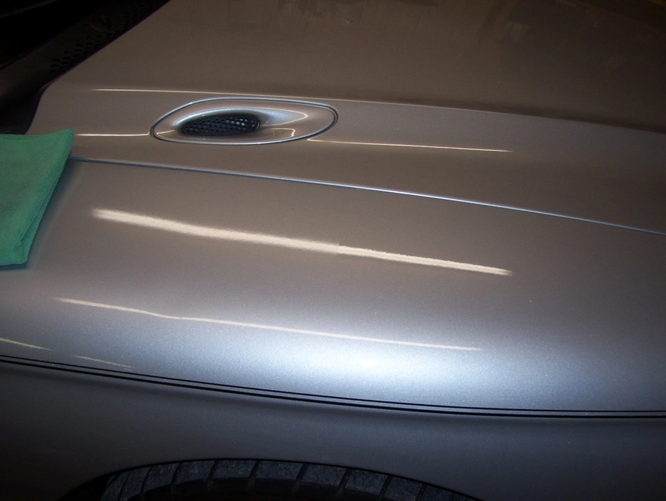

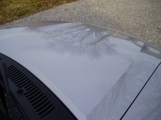

Here is a pic of just how bad my car was (nearly 2 years since it's last full detail, and that was without a Porter Cable). This is just one pass with the 105.

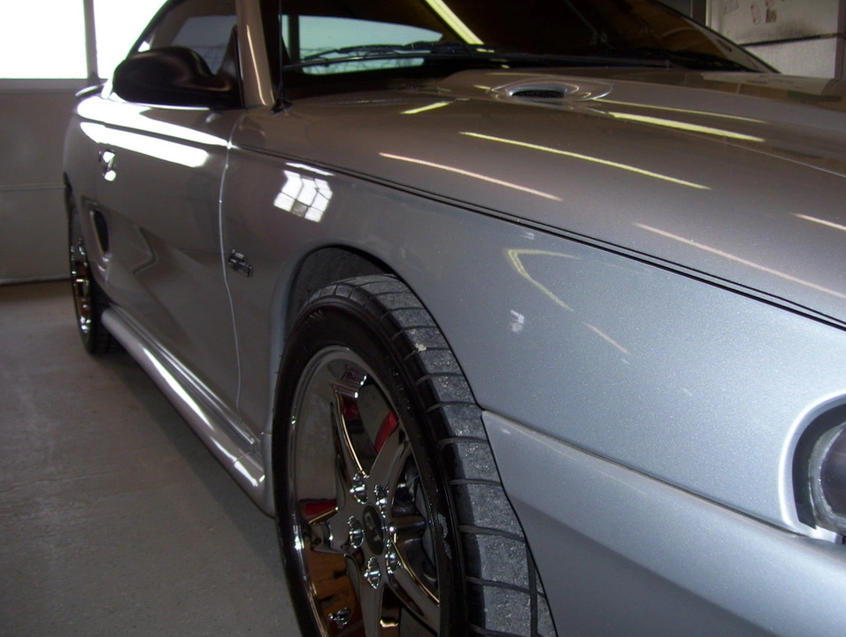

And here's a couple after I was completely done (unfortunately shot with a 8 year old point and shoot). Hoping to get some better pics sometime soon.

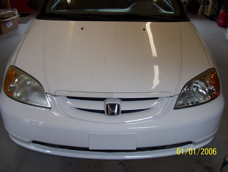

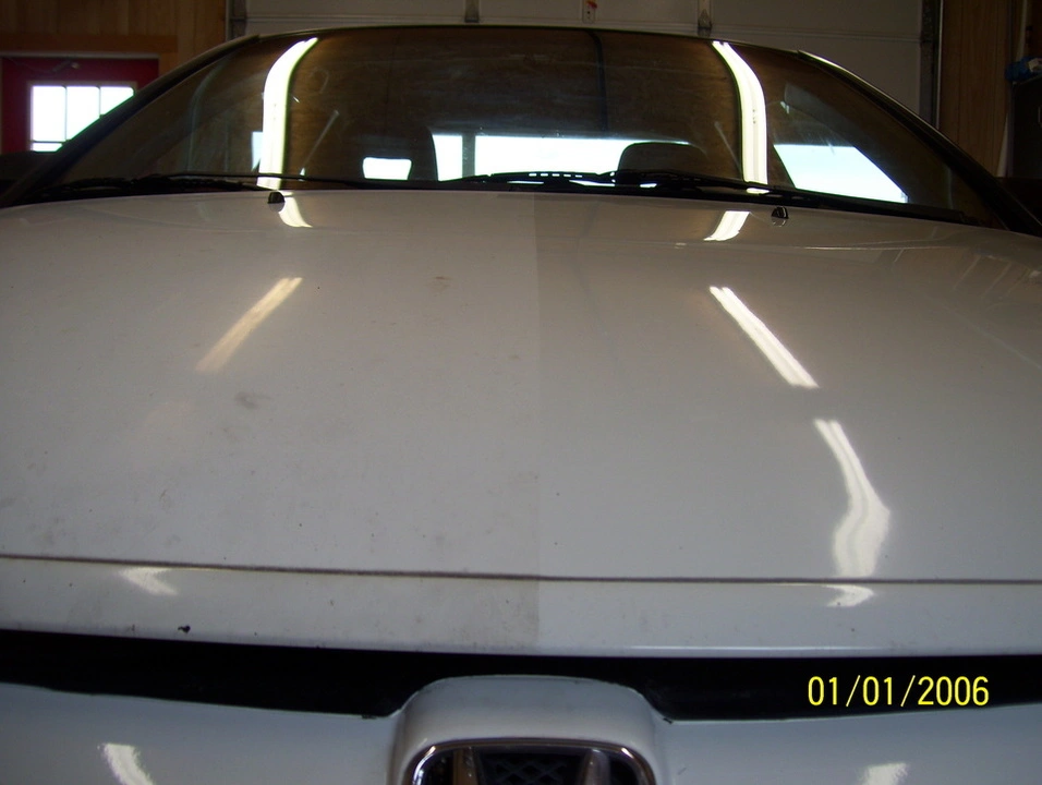

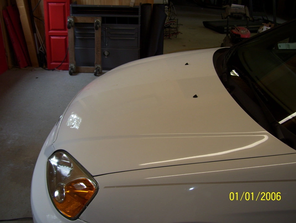

Here's some pics of my DD that I've had for a few months. It was in AWFUL shape when I bought it, but I could tell that it was fixable. M105 worked wonders on this thing. it finished up so nice on the cheap Honda paint that I didn't even follow up with 205. These pics are just after compounding with the 105. It took 3 passes, but holy cow does the paint come back.

your car looks awesome. super super clean. even the honda looks great. nice 50/50 shot of the hood - very nice work there ! ive always wanted to try the 105/205 combo but i have so much CG stuff, i hate to buy more ( although from what ive read, 105/205 is better than CG's compounds & polishes ). ive also been wanting to add #16 to my collection but its terribly hard to find - any ideas when it can be found?
you need to give the autoglym a shot. i know you will like it. great slickness, great reflectivity and great durabilty. last spring i used CG xxx for my lsp. the spring before that, i used the HD wax. neither disappointed.
