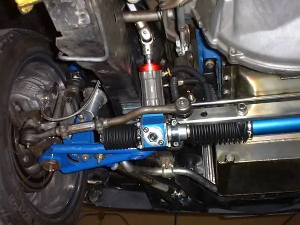

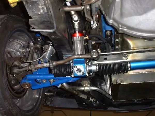

Here's a good shot of the TCP rack installed.
Flaming River rack
