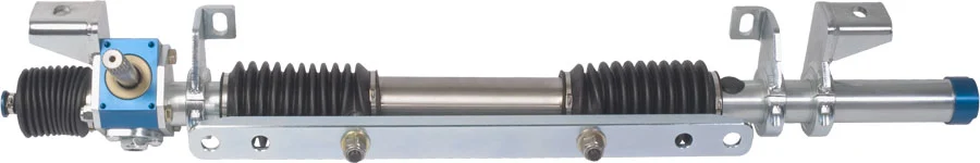

66Runt said:
Is that at your normal ride height?
Centerlink travel of the TCP rack is limited by internal stops within the rack. The two centerlink studs ride within slots in the rack tube. The visible tube between the two rubber boots is a dust cover and moves with the centerlink. Regardless of suspension position and even without tie rods hooked up the rack travels a maximum of 6.375".
I take this to mean the TCP stops are non-adjustable? If so, the only way to increase lock (travel) is to shorten the tierod mounting arm on the spindle. Easier said than done, and the side effect is less mechanical advantage.
