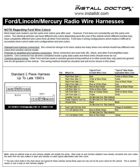

there is a dimmer ground at the radio, i accidentally used this as a ground for the radio and had the same issue. i can't remember what color it was orange and black or green and black i really can't remember.
The 12v acc wire im using for my stereo is orange and black. im going to try and unhook it and see if my dash lights work again. I just dont see how it would be a ground wire when it has 12v going to it with the ignition in the " ON " position. All I do know is that the 12v goes away from that wire as soon as I turn the headlights on lol. I tried adding another ground strap to the engine I had laying around. Obviously didnt change anything. Thanks for the suggestions guys
