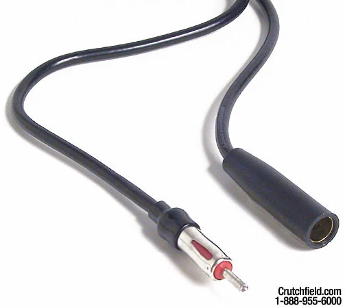

Is this what the antenna plug that plugs into the stock radio looks like? If it is maybe I broke off the nipple end and it still inside the radio cuz mine isnt like that. Anyone who took out there antenna plug is this what the plug looks like?

I think you have the same problem i encountered.... Ok that pic you posted... see the male part... i think that is stuck in the socket of the back of the radio, and you pulled the antenna wire outta it... if i understand correctly. Get needlenosed pliers and grab the edge of it and pull it out of the radio... it might bend a little but don't worry you can bend it back. Its a PITA to get it but get that out and you can put it back on your antenna wire.
If you go aftermarket CD player as i did and reccomend... you should call crutchfield. They have a harness that you splice into the aftermarket deck, but plugs directly into your cars harness. soo no splice and jerrry rigging you cars wires. it's like $15-$20 bucks..and well worth it, they also sell an antenna extender like that pic you posted. PM me if you need anything
Thanx for the reply, the antenna plug was stuck in there and after a half hour trying I finally pulled it out, only problem is the wire is a 1/4 inch long inside the plug so i don't think I am gonna be able to reconnect it to my cable. I called the ford dealer :mad: and they want 32 dollars for a new cable :bs: :bang: :bang:
