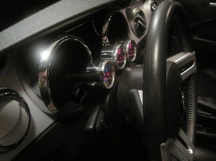

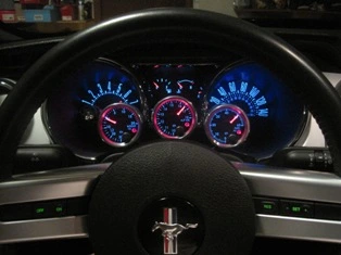

Finally done!
Well, I finally got my gauges done. It was a pain but I think that they turned out good. I have a boost/vac, A/F WB, and Fuel Pressure gauges. I am using custom speed hut gauges, a raptor shift light, and innovate motorsports LC-1 controller. I fabricated the gauge pods from aluminum and built wiring harnesses for all of the wiring. I went with the analog gauge for the A/F because I did not like the way the digital gauges have the digital numbers jumping all over the place. My a/f gauge has a warning light that you can set up to indicate an a/f ratio that is too lean or rich at 70% throttle to WOT; this prevents the gauge from giving warnings during normal driving. I can also data log the a/f with the innovate software. I will be adding an analog unit (SSI-4) to data log the vac/boost, fuel pressure, and rpm. Doing this install was more difficult than the supercharger and I am glad to have it done.

those are cool, well worth the work i hope. does it block the drivers view of the tach or the speedo at all?
A little bit but not too much. It blocks the tachometer after 7k and speedometer up to 10MPH. Other than that you have a clear view. The center gauge is blocking the oil pressure gauge and the battery gauge. This was the advantage of going with only the two gauge setup. Not a big deal for me though.
