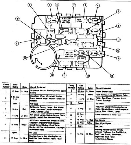

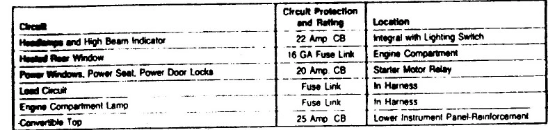

BigHairyMonkey said:
. Another question, is there anywhere i can find a list of which fuses are to what because i dont have the factory manual.
Courtesy of S&2B's site is the fusebox diagram. Do note that this is likely based upon an '88 GT, so there might be minor differences.
