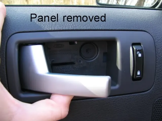

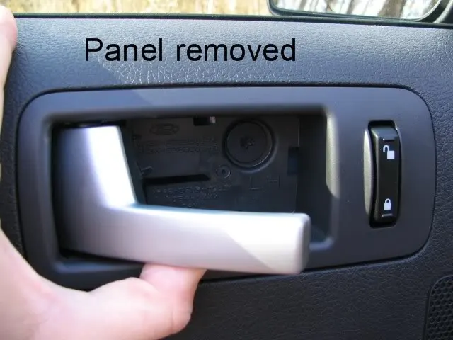

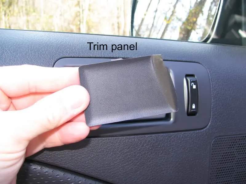

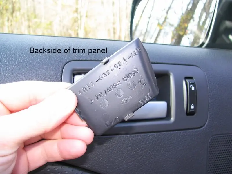

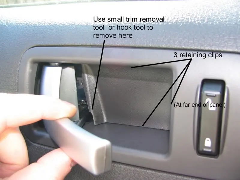

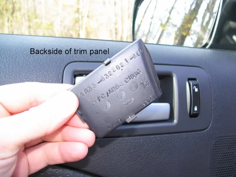

I was driving with the radio off on Saturday and noticed a new rattle. It was coming from the driver's door. I pressed my hand against the door lever trim and it stopped, let go and the rattle came back, pressed the trim again and it stopped. If you take your finger and tap on that trim piece you can notice how loose it is. Ok, so that was an easy find...now onto the easy fix.

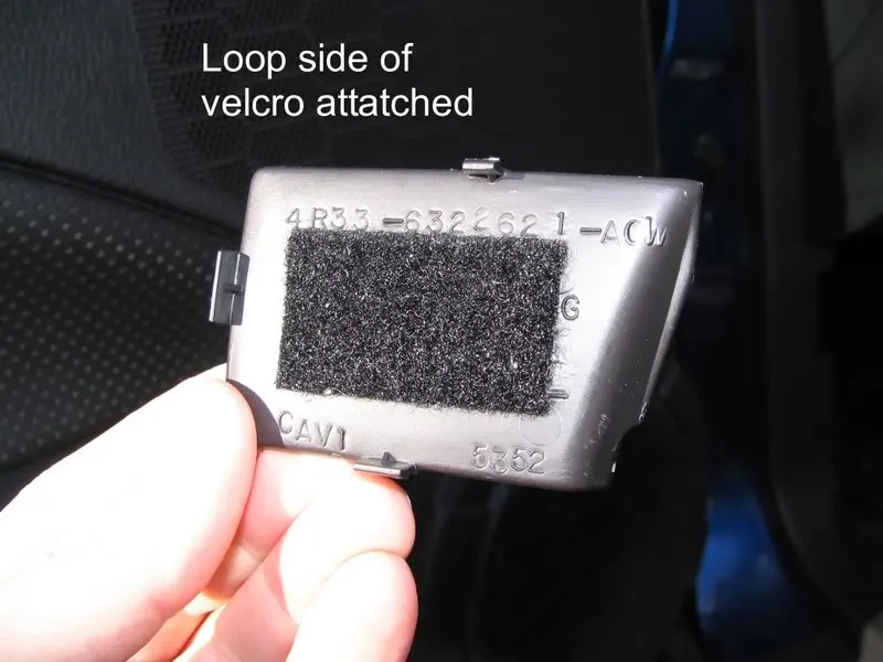

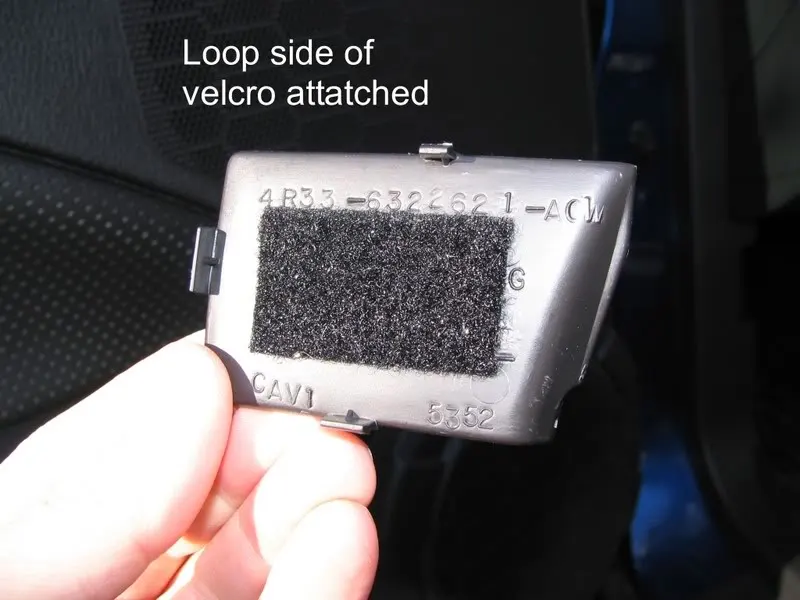

I took off the trim piece behind each door lever and attatched a short strip of the loop side of velcro. This provides just enough pressure so that when the panel is put back in place it has a tight fit with the door panel...no more rattle!!!!!
YES I KNOW, it meant to be TOOL not TOOK in the first picture...
Now to find a decent fix to the glovebox handle rattle...

Thanks Kooldawg. I've got the same one on the passenger's door. I've also got tone that seems to be coming from either theoutside mirror adjuster or the panel in which it is mounted.
You're welcome Marine One.
Perhaps I will leave the glovebox rattle alone. I don't want to fix all her problem areas to the point she looses ALL of her charachter...:(
Mirror adjuster actually turned out to be the door handle so I did both of them tonight after I got home. Instead of the velcro I used foam insulating tape.
