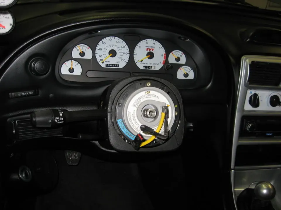

RE-Installing Clockspring...ANY advice?

It's wound wires that that rotate with the wheel and allows the connections of the airbag and horn. Since the wheel turns the wires need to turn with it. It can wind a total of about 5 turns from one end to the next. Postioning on the reinstall is critical...the wheel has to be centered and the clockspring also so it can rotate in both directions without running out of wre. They are NO longer made for the 1994's. The 95-98 ones are the same...go figure.
Since Im down to 2 from a junkyard, I have to make sure if one is good I dont screw it up, so Im trying to get as much info as possible.
Thanks
RC
