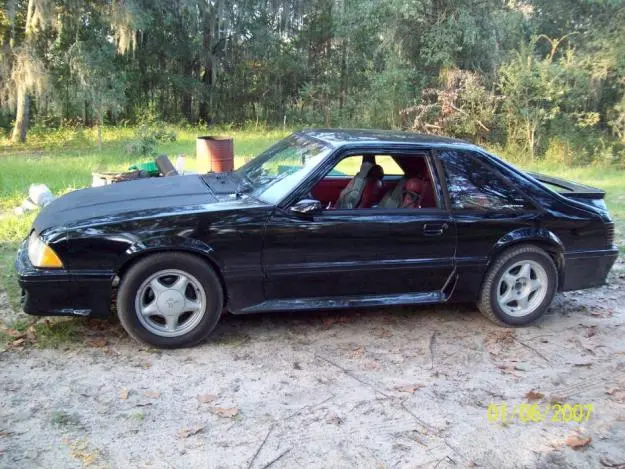

like this one??????

There are LX models with original V8's, if thats what your wanting to know. Like the guys said. The Vin number will tell if anything has been changed. But chances are unless they specify the change, it is an original V8.

spiker said:
like this one??????
Does the vin # have a "D". you can post us pics all day, meams nothing I can show you hundreds of pics of GT's with cobra kits on them. Go to the vehicle and verify the vin at atleast get it and stop looking at pics.
