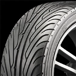

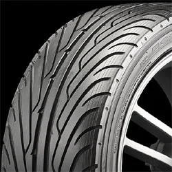

We have the Yokohama AVS ES100's on the wifes car and love them. Very stiff sidewall and good all around traction. Much better than the stock goodyears. $116 bucks a piece for 245/45/17's
http://www.tirerack.com/tires/tires...rch=false&partnum=54WR7ES100&fromCompare1=yes
