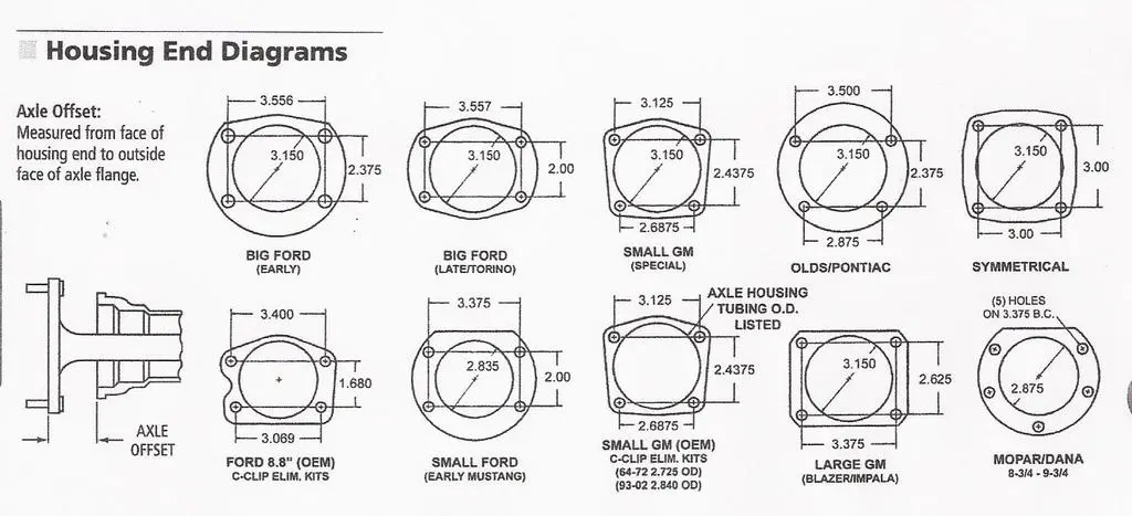

Brakes Rear Brake Conversion, how to tell small from large? 1970 Mach 1 4 Spd 3.75 rear
Its pretty easy. Is the flange flat at the top? If yes, you have a small ford, if the flange has a "peak" at the top you have a big ford, if it also has a "peak" at the bottom, then that big ford is late rather than early...and of course double checking by measuring bolt pattern gives you peace of mind.
