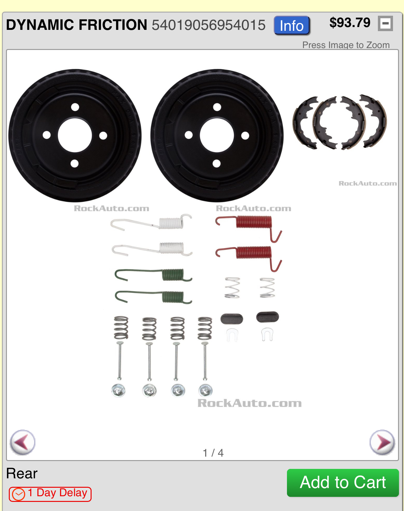

Ordered this kit from Rock Auto.

That should do it. While your at it ,get plenty of brake juice and flush the system out.

Make sure to remove the adjuster, clean it, and get a tube of lithium grease to lubricant it. Also, use a brush to lube tje three points of contact each brake shoe makes against the backing plate. If you’re not sure what I’m talking about, I’m sure there’s a YouTube video of someone doing it.

Or just replace them. Seems like most everything in there is gonna be new. The adjusters themselves, and the self-adjuster parts (the levers, cables and cable guides) are about the only other parts that seem like you're going to re-use. For a few bucks more, you can have pretty much everything in there brand new.
