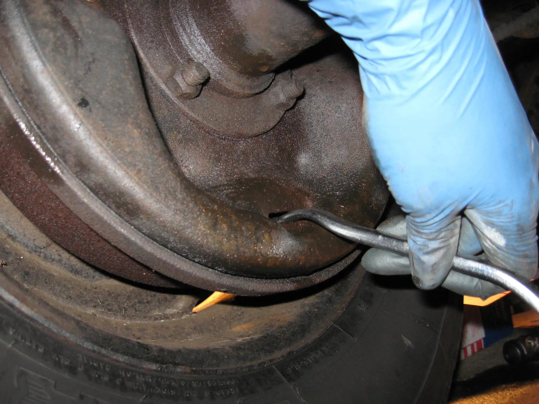

What I have done to get drums off that will not just pull off is to go through that hole with a small flat head screw driver and push the adjusting lever away from the adjusting screw. Then I use another flat tip screw driver to back the adjusting screw off which will allow you to remove the drum. I believe the left side adjusting screw has left handed threads and the right side has right handed threads.

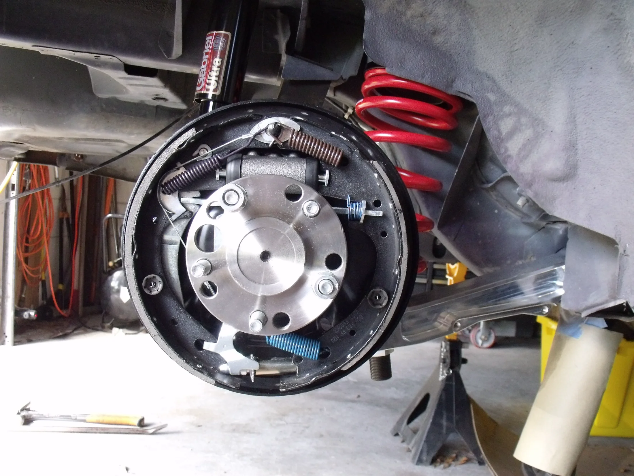

New rear brakes on my 83 mustang
