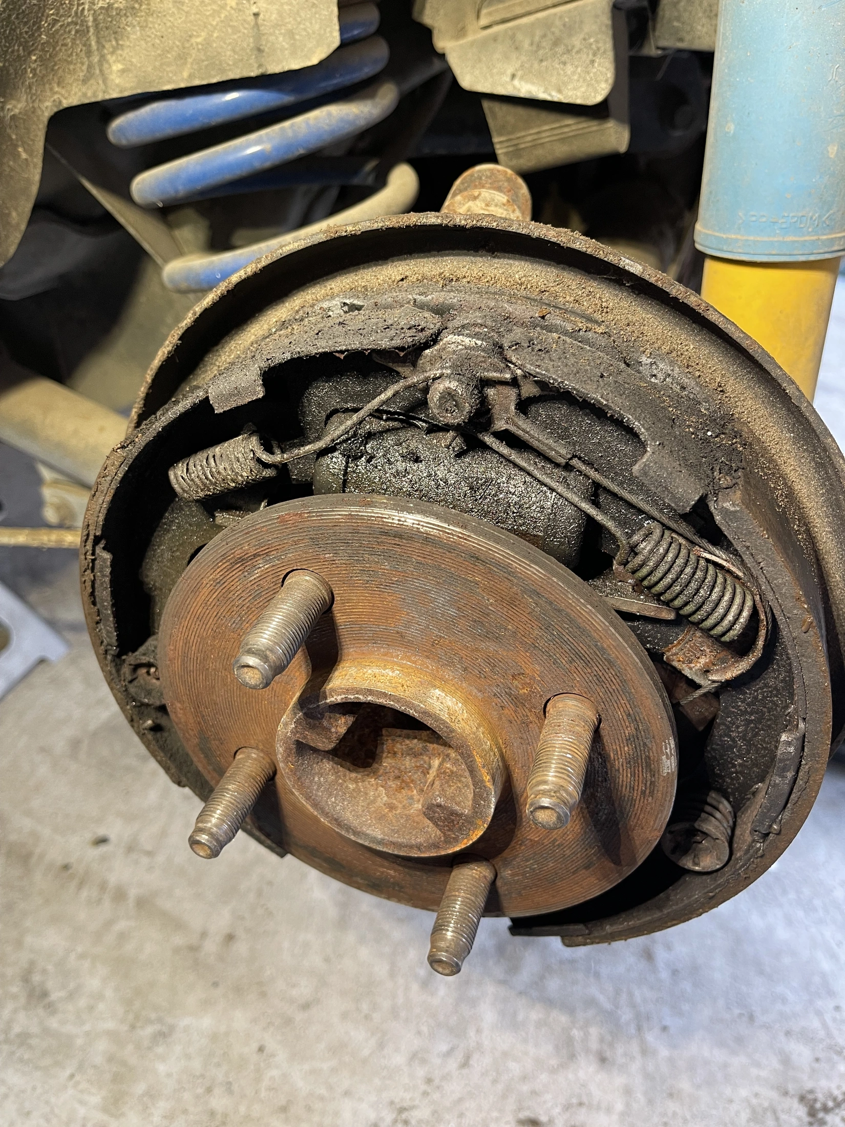

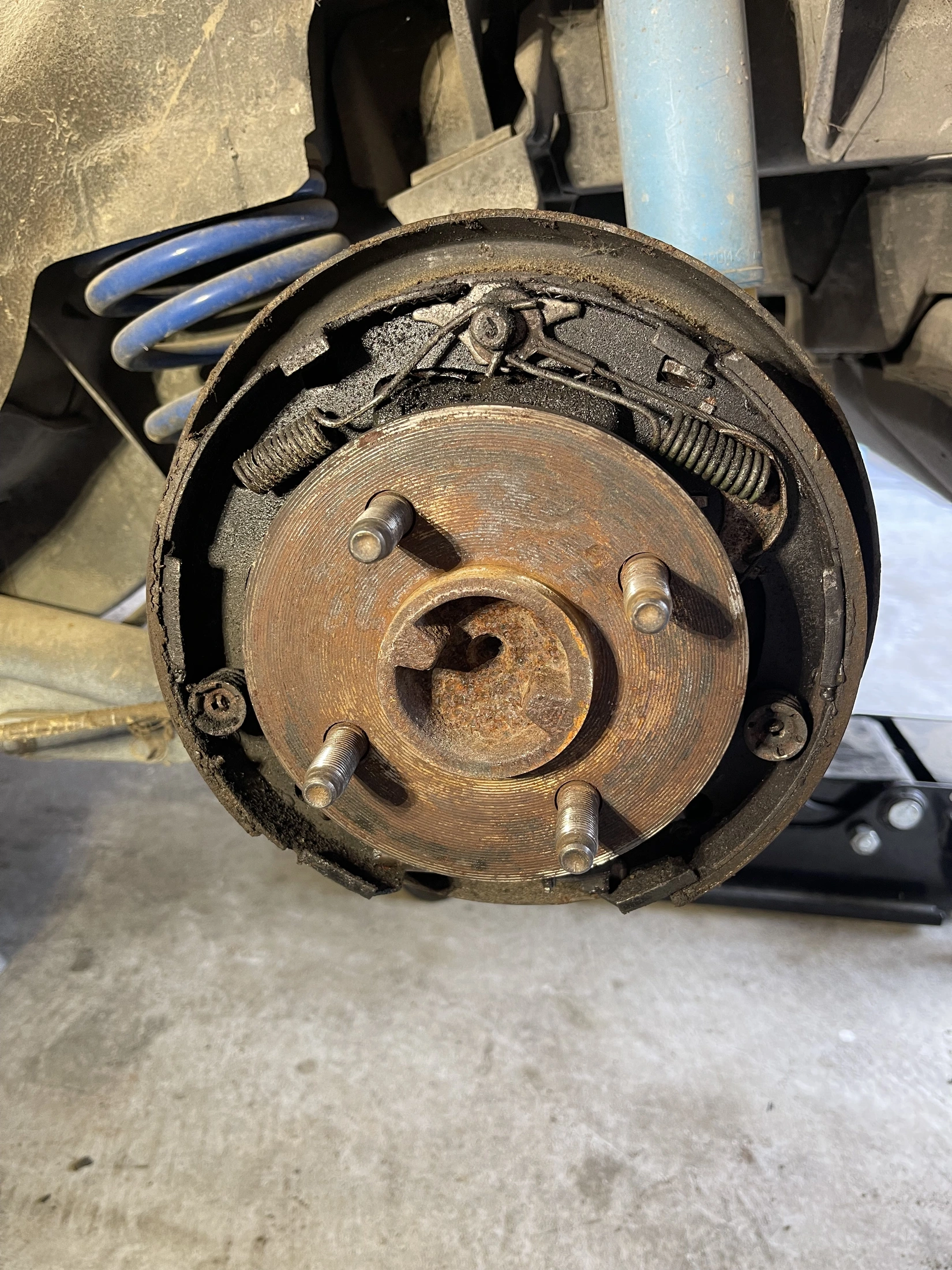

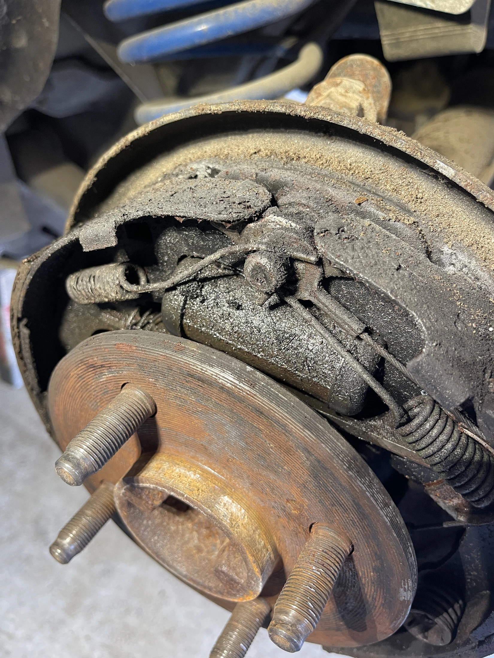

I think I found the issue. Was able to get the drum off and looks like the cylinder is leaking.
Reactions: limp
Axle seals looked good. Can I replace the cylinder without removing the brake shoes completely? Can I just remove the primary and secondary springs to spread open the shoes enough to remove the cylinder?
Are you going to do both sides???
Only remove and install one side at a time so you can look at the other side to help you figure out where all the springs and things go..
Smaller shoe goes forward.....
do not throw any of the Old springs and things away until you compare them with the new spring kit... Make sure all of items in it are correct.. Sometimes you have to reuse a couple of items

Yup, doing both sides. Thanks for the advice. Not gonna lie, all the springs don't look like fun but I need to get it done.
