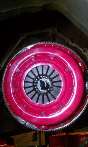

New rear main, pilot bearing, clutch kit and the car runs WAY better than before.
The project started off very smooth, until I went to drop the transmission. Got the transmission to budge about an inch, and then it wouldn't pull out all the way. I tried to wiggle, it off, no luck. I jerked and pried for almost 3 hours, with no improvement. I was doing this alone, so I didn't have much help pulling and prying lol. Well after 3 hours, I decided to reach through the housing fork hole and take the bolts off the pressure plate. One by one, turning the crank so the bolts were accessible, I finally got it off. When I got the last bolt off, the tranny dropped! YAY! Lol. I am guessing the transmission was wedged in a very odd way that it wouldn't come loose from the pilot bearing?

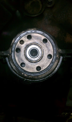

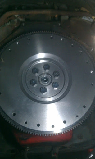

Well I got almost everything off, and the while I was loosening the flywheel bolts, they were caked with oil on the threads. I knew here, that it was a rear main leak and not a valve gasket or an oil pan leak.
Taking the rear main seal and the pilot bearing was not hard at all. I don't understand all the difficulties people have/had. looking at my rear main, it looked fine, no visible damage, but it wasn't obviously doing its job anymore. I used a small puch and a mallet, and hit the outer side of the rear main in. Carefully of course, making sure I don't nic the edges or the crank. After I got a decent dent in it, I then used a flathead screw driver and where I put the dent in, and pryed the old one out. It was soo easy, I couldn't believe it. Putting the new one in, was even easier. I applied White Lithium Greese to the outer and inner part of the seal, put it in position and used the old seal as a pusher, while I hit in a cicular motion with a mallet to get it in. Slow and steady was the way to do it. Making sure it was going in even was my biggest concern.

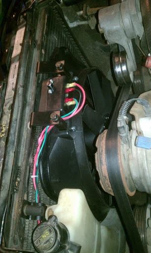

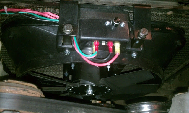

While I was doing all this, I did the electric fan setup. Easy as well for the most part. Works very well for right now too. I got the ProForm fan and plan on doing a wire clean up soon in the engine bay. Anyone know of a write up, please share :)

There is one dowel pin. I misplaced the new ones I got with the kit, which frustrated me, and after I put the car together, I found them on a table towards my bathroom. I guess I set them down when I went to use it lol. My old flywheel had one it in, so I punched it out and put it in my new one.
hey you made the effort ! I forgot to order mine and i ended up doing the same and Punching them all out and in the new one

Doing it this way, took 5 minutes, if that. Just be VERY careful you don't slip and nic the crank or anything around it for that matter. Make sure everything is smooth, no notches before placing the new one in and use White Lithium Grease. Inexpensive and makes job much easier. Have any questions, just ask :)
