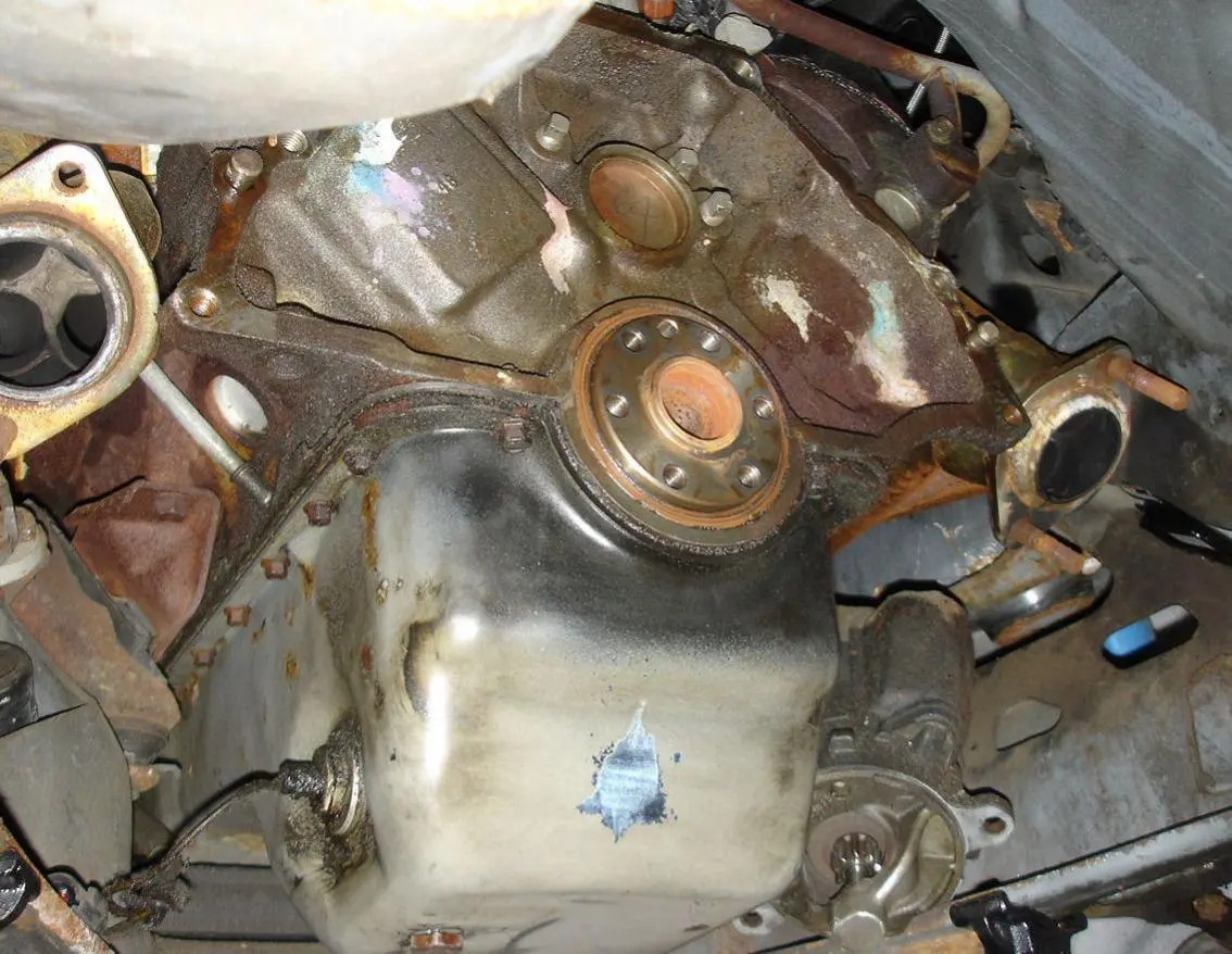

Here ya go. In this pic, the seal is reddish brown.

yeah i already have all the "interference" removed. thx for the pic. i just wanted to clarify what i was pulling on.
