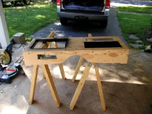

I removed all of the rear seat components and covered the fold up sections with black cut pile carpet to match my interior. Then I used some cardboard to make a template of my idea. I made the frame out of 1/2" A/C plywood.

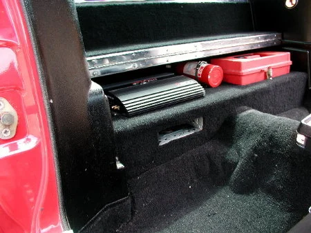

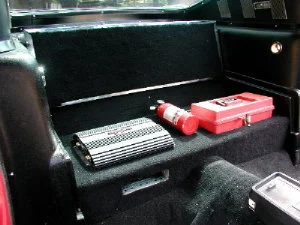

Here is a picture of the finished product. With the folddown section down, everything looks stock. But once I fold up the cover, there is a platform for my amp, fire extinguisher, and a recess for my tool box.
The hole on the verticle panel, under the amp, is a single din for a CD Changer.

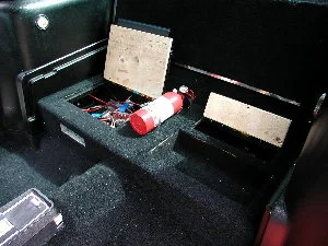

The platform under the amp is hinged to access the stereo wiring and there is an additional compartment behind the tool box for my Painless fuse block

Tim

67coupe351w - Yea, with the fold down in place the only thing visible is the CD player and you can't really see it though the window.
