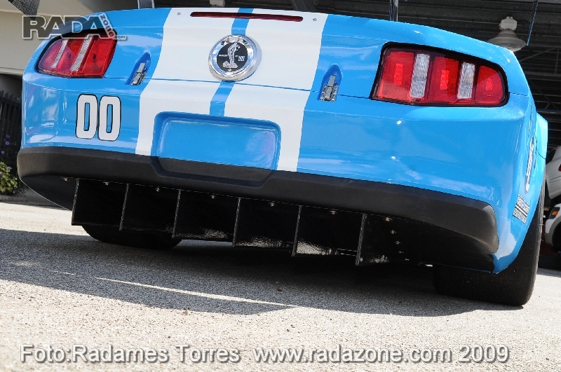

Little hint - big meats out back don't help you turn.
Really? Gosh so many people must be so wrong...including Ford. You should share this "little hint" of yours with them...those "big meats" are just slowing down their 2010 Trans Am Racer. :rolleyes:
You call BS but that's simply because like most here, you don't know what you are talking about. And that's fine, just be ready to acknowledge that instead of acting like some public advocate responsible for calling other people stupid for not getting excited about paying $60 to hold the gas pedal down in a straight line.
Really II ? You have no idea who I am or what I've done, do you? And for the record, I didn't call anyone stupid...you View attachment 222823 . View attachment 222824
