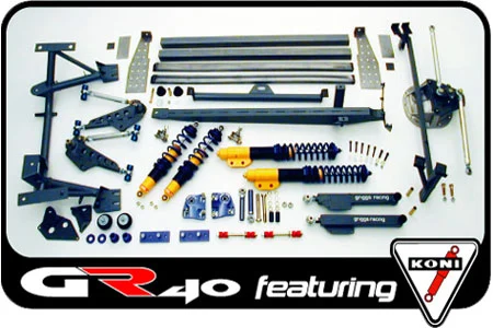

Neither MM nor Griggs (I may be wrong) sell such an animal nor do they recommend it. The rear is tied together by the frame, the trunk floor, as well as the upper pillars and body panels, whereas the front isn't. Hell, Griggs doesn't even offer a front bar in their top GR-40 package:
On my car, with all the MM parts I had, there simply wasn't a use for it. IMO, the rear bar is more of a gimmick from the import world more than anything.

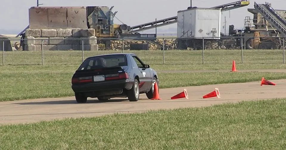

I say that because of experience in auto X. I have several 1st place finishes for my division back when the 88 was more setup for handling. Without being completely insane, there is no way to truly test suspension parts on the street. It is impossible to see the levels of grip and limit of the tires on the street like you could experience on the track... and if you are SHAME ON YOU FOR DOING IT ON THE STREET.
Ever been to an auto X event? There are slaloms and quick changes in direction... sure you can do a steady state corner on the street on a highway onramp, but that is nothing like what you do on the track. At the track, if you don't spin a few times, you aren't pushing it hard enough. Come even close to spinning on the street, and you risk the life of yourself and everyone around you.
Back when I was doing the auto-X stuff in the 88, I put stiffer springs and heavier sway bars in the 88, and on the street there was definately a big feel of the pants gain. There was less body roll and increased grip... but on the track it could turn into a whole different animal. The back end became MUCH less predictable and would bite you in the ass if you pushed it just a little too hard. It was great fun, but that particular combination wasn't any faster because it wasn't well balanced... and you don't learn that until you really PUSH IT HARD! So my point is, you can't and shouldn't push the limits of the car on the street, to really see the true effect of suspension changes.

/Auto-X.jpg
Well good for you. I see what you are saying about how the springs and swaybar might have felt better on the street but were worse when it push came to shove. But we are talking about a brace here.
Theres a difference between noticing the effect of a new brace while driving the same roads you drive every day, and testing your spring/swaybar combo driving around your neighborhood. I think you know that.
Autocross isn't "the track." And at most road courses, spinning a few times is the easiest way to get kicked out. If they don't park you for the day the first time your tires hit the dirt. Nobody wants to share the track with a nut job intent on "pushing the limit."
I've done a few autocrosses. I understand what you were trying to do with your stiffer springs, but I could have told you that stiffer spings and a stiff swaybar weren't going to help. And I'm sure you would have argued and found out on your own anyway. Here you have a chance to learn from someone who has done so, and all you do is argue. WTF?
