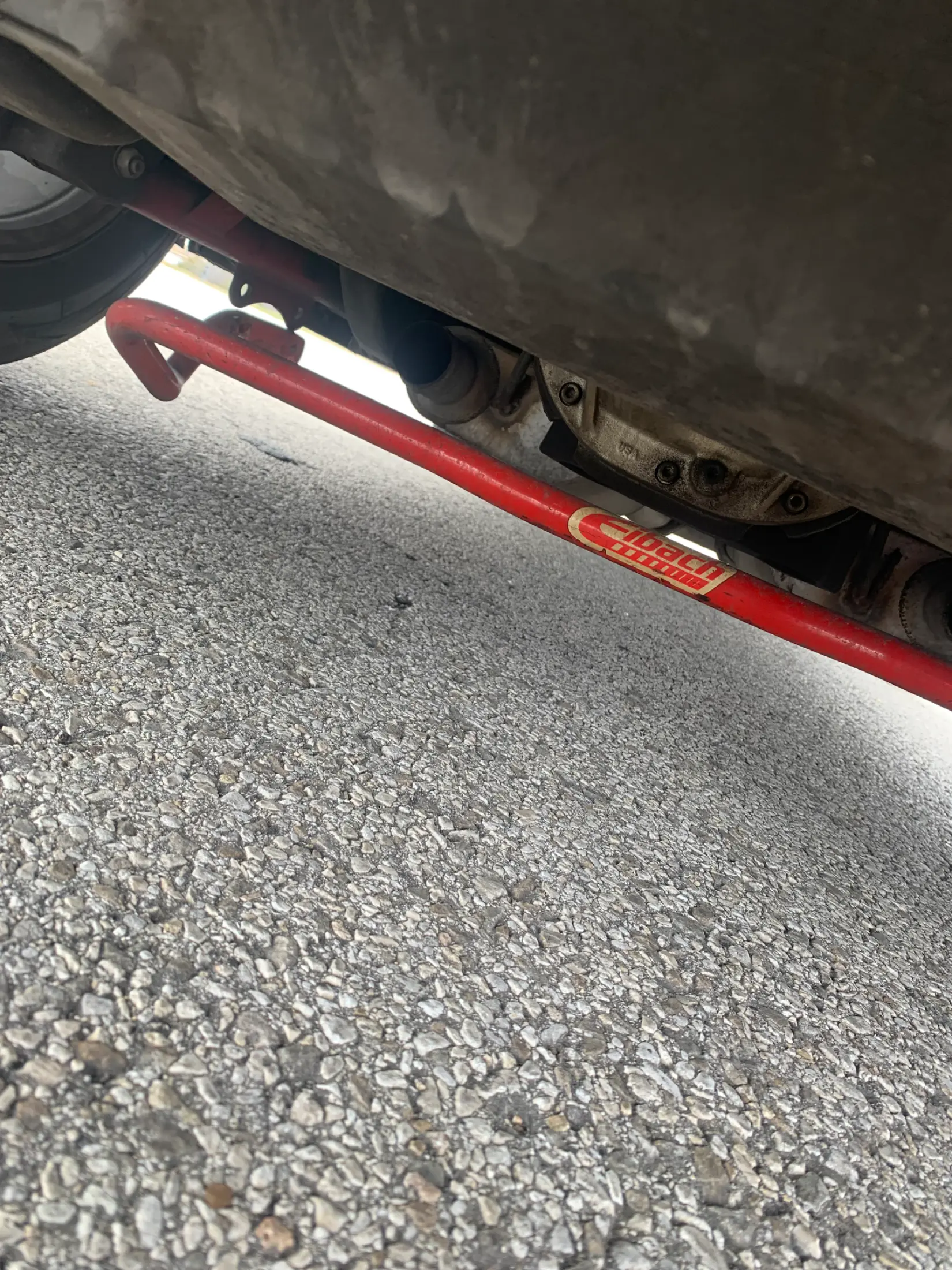

1989 foxbody coupe driving and I hear noise pulled over and saw this. Elbach sway bar popped off the drivers side control arm. Both bolts were gone.
I installed bolts and when I was going up an incline into gas station i heard a really loud pop and I felt it somewhere under me.Got under car sway bar ok. Had this ever happened to anyone? What could cause rear sway bar bolts to break off one side? I don’t want a control arm to fall out any ideas on what could cause this

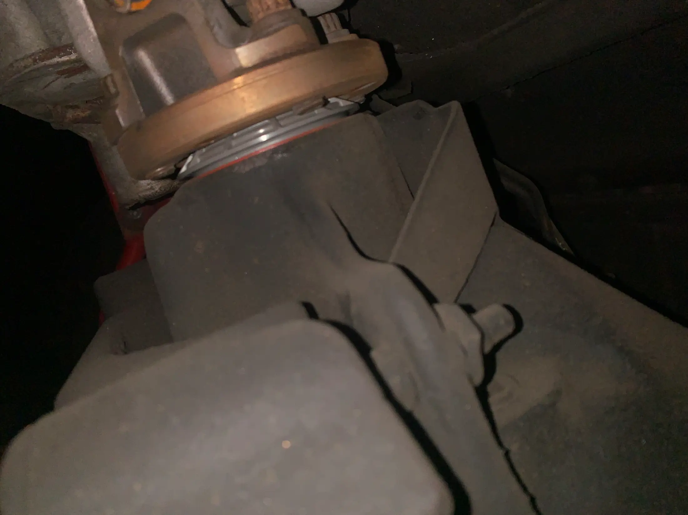

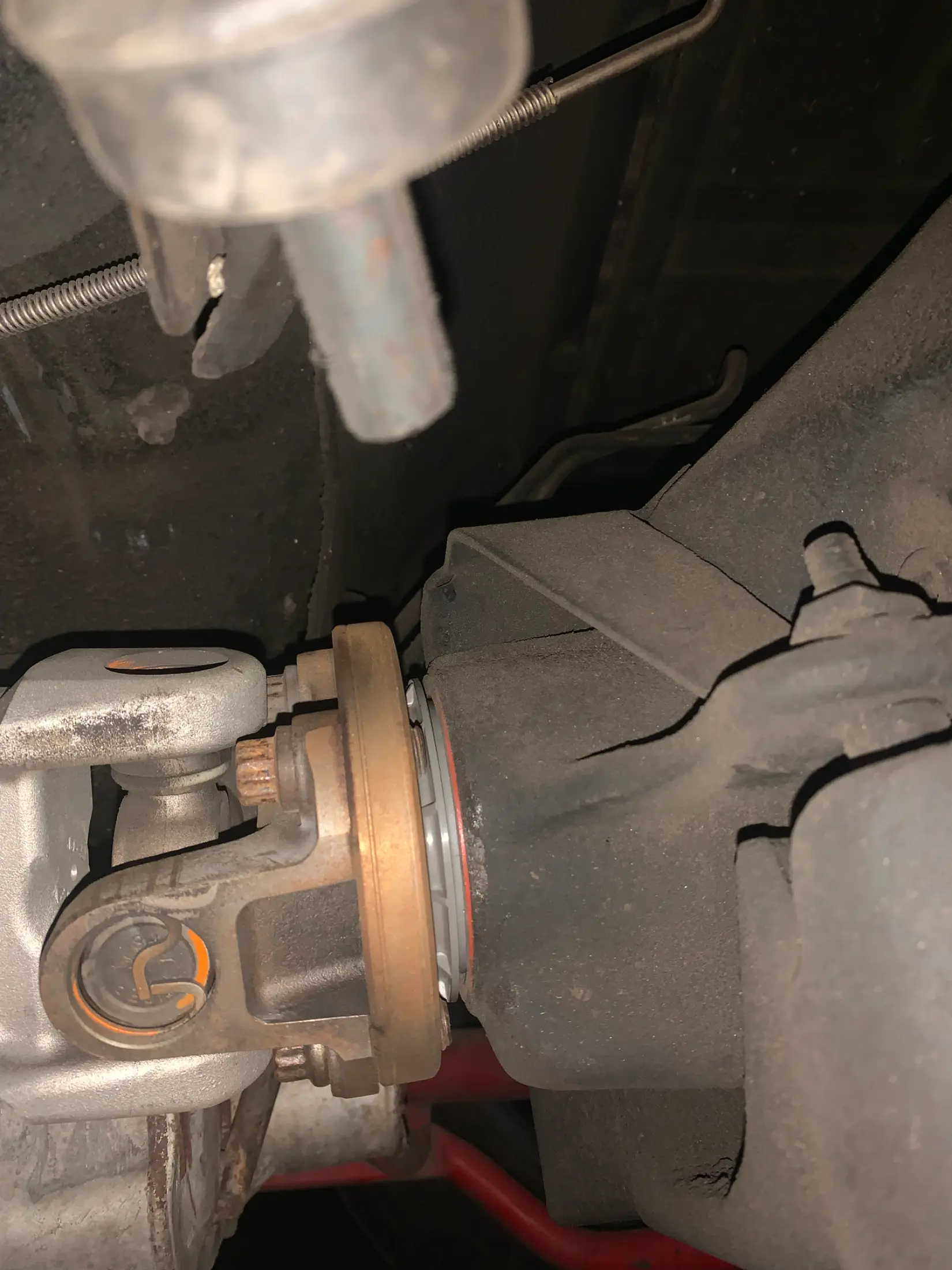

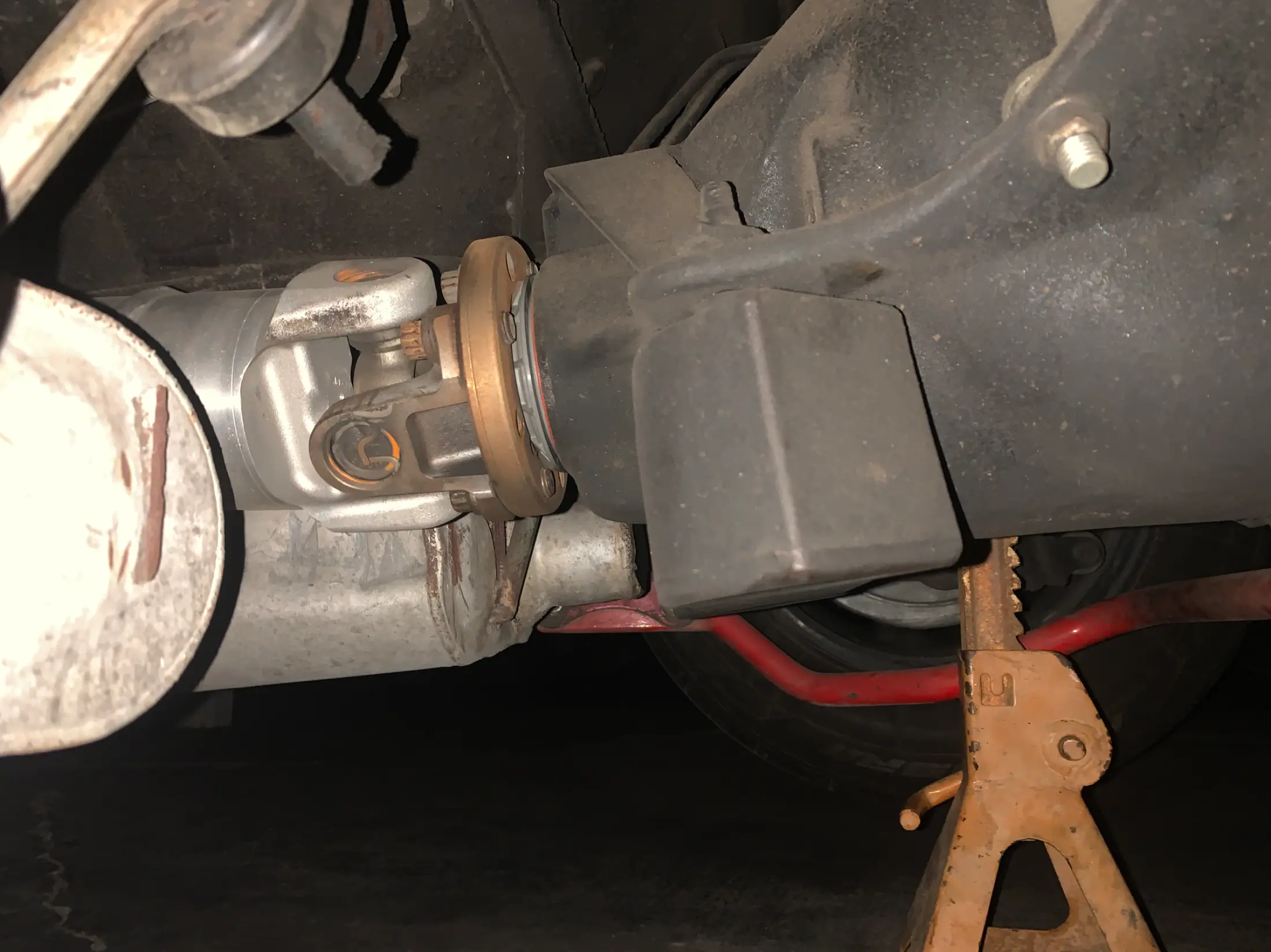

Supplied ones came with the sway. Any ideas on what would cause this? I’m looking everywhere and I don’t see anything. Does this look normal to tou. Pinion shaft I see something that looks like grey plastic
the grey plastic part thats on the piñon flange to me seems like it’s walked. I know that plastic part dosent sit flush. I don’t know I just know I heard & felt a loud pop & don’t want something to break off while I’m hauling ass on hiway
Guesses:
Wrong bolts (lots of folks use hardware store bolts not knowing that they're Grade 5).
No locking feature on the bolts or nuts (Nylocks, for instance).
Something in the suspension is moving around. Maybe a bad bushing, hem joint, whatever is in there.
