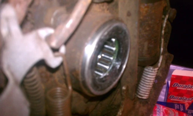

I just finished installing my 3.73 gears and trac lok rebuild. While I have axles out mine as well put wheel bearings in right? Well I'm trying to install my second set because the first ones broke after trying to beat them in with a seal driver. I went to autozone and bought the all in one repair bearings (DRP5707) because the shafts have a tiny bit of a groove in them so why not. Again, even with these bearings, I can't get them to go in all the way. Any tips or ideas? I greased them and going back and forth between the seal driver and using the old bearing. I'm going to break these bearings too. One of the oil seals springs already fell out, is it shot now? Help!
You shouldn't have to freeze the timken bearings. They are fairly easy to install (I used a large socket). I bought a set of those all-in-one bearings but also bought a set of the timkens and seals when I changed my bearings. I ended up using the timkens. I could see from the size of the all-in-ones and the space available in the axle tube that they would not seat completely. Good luck.

Thanks for the help everyone. After having to remove the gears to get a big socket and extensions and beating the hell out of the duralast ones it was able to pop out. I bought new timken ones, measured them and the timken was slightly smaller. Went right in! I never learn my lesson. You just can't cut corners!
