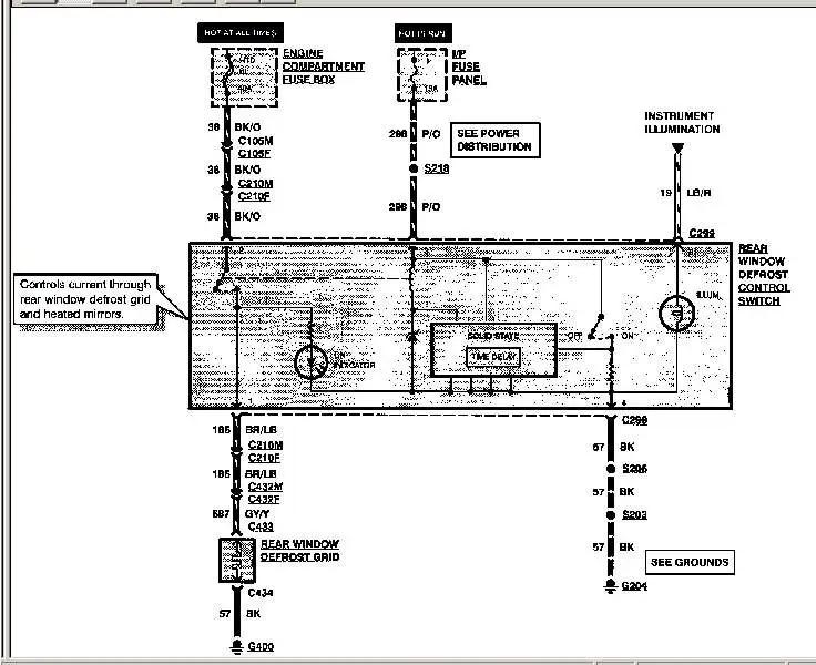

I just recently purchased a 1995 Mustang GT convertible. I would like to replace the original rear window with one that has the defrost grid in it. Does anyone know if the car comes prewired for a rear defrost even if the car didn't come with the rear defrost? If the wiring is there, how can I find which wires are the ones I need?
i don't know if the wiring is there but here's a diagram for it.
