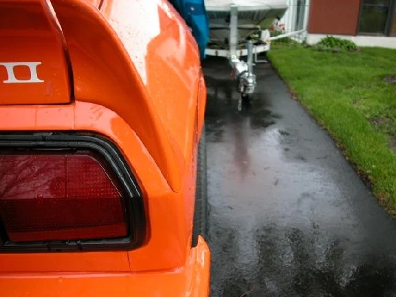

How about fitting an 8.8 rearend from an 86 Mustang ,they are cheap and you just rebuild the clutches(sometimes they are OK) and weld MII spring perches...It`s an easy bolt on and there`s a lot of gear to choose from...It also fixes the back spacing problem 0f the 8 inch unit....you can put Fox mag on no problemo and the II whells get close to the fender lip and fills the wheel well! Anything goes...the other alternatives are also good too not to mention that changing gears is much faster on an 8 inch rear...
