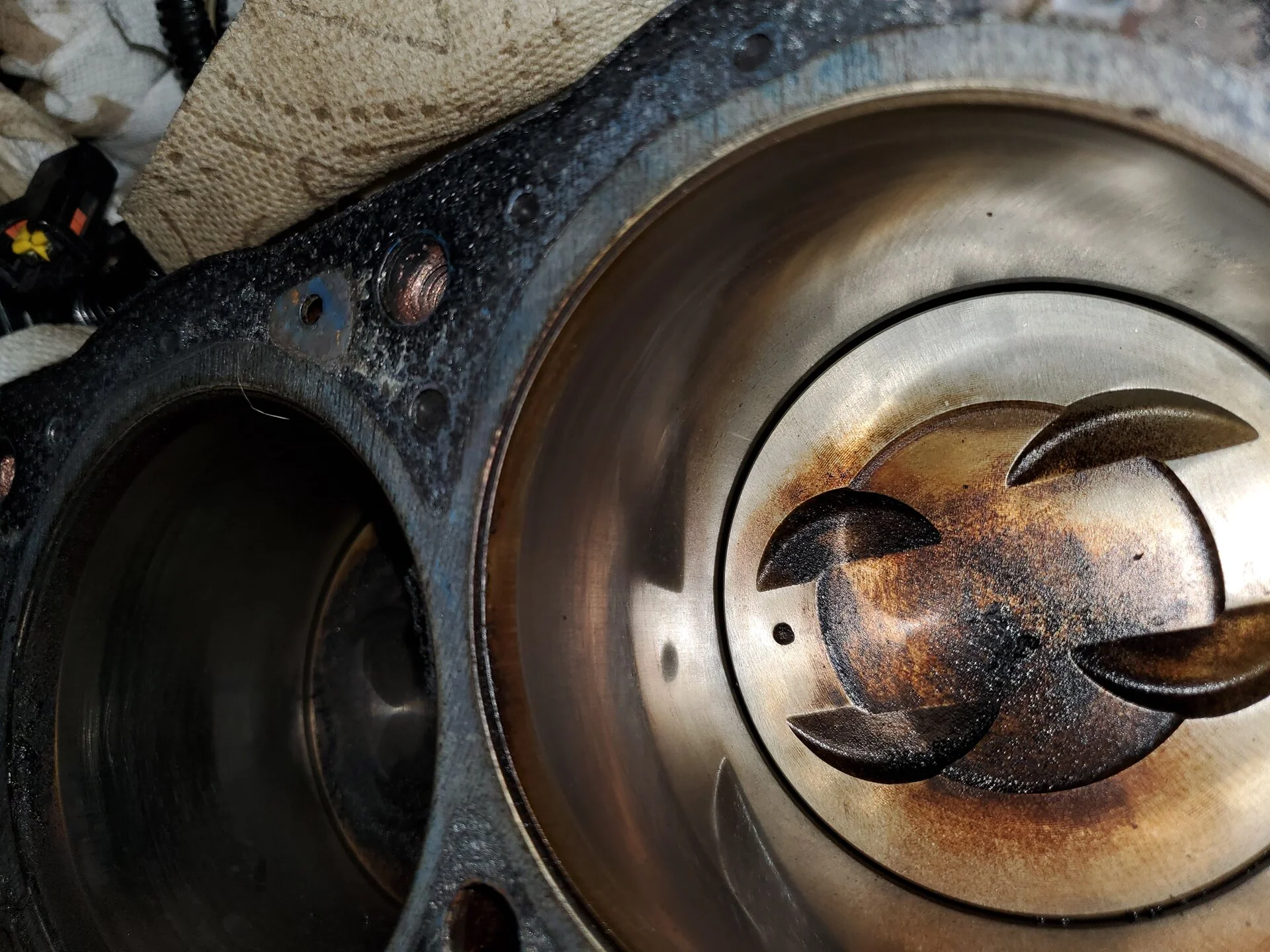

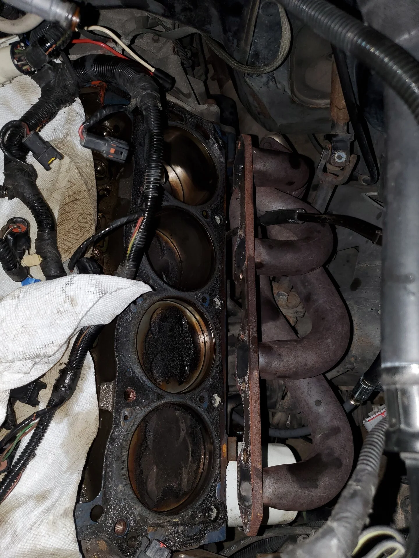

Again, I am new to getting this deep in an engine. #8 plug looks like I dipped it in mud. You can see the #8 valves in the pic above look pretty bad and #6 is starting to get that way. The rest of the plugs are pretty lean. Maybe I am overlooking something else?
I agree but we don't know the miles, it was just my opinion.
I have just under 100k on the car. Not sure if anything was ever done to lower end. here are some pics of #8

Just spoke with previous owner. It had new rings and bearings less than 20k ago.
Which would beg the question, why did an 80,000 mile car need new rings and bearings, when they typically last at least twice (sometimes triple) that?
I'm guessing at this point you are thinking it's the valve seals which is why you are considering heads or head work.
Couple things, valve seals are rarely the culprit and the compression is unilaterally on the lower end.
Next, i rarely trust any rebuilt 302. I'd rather have a factory explorer shortblock than one that is home rebuilt.
Just one of those things that is never the same the second time around especially since nobody has a clue usually about the builder.
Right now, i'm not thinking heads are not your solution.
Edit: I added NOT, it's hard to see this forum on my phone since the keyboard covers the bottom of a long post, so i missed it my proofreading.
Spoke to PO (thinking fairly descent engine guy looking at the other stuff he built in his garage) about this. It is the original block. He bought the car from his buddy. His buddy changed the heads, intake and cam. After he changed all that he got mad because it was smoking and sold it to the guy I bought it from. PO figured since he had done the top end, he'd do the bottom end thinking a ring was causing the smoking problem. He took it apart and had the blocked checked at the machine shop and put it all back together with new rings and bearings and it still smoked. He rechecked everything and found that whoever did the heads didnt install the valve stem seals so he put the seals in and it took care of the smoking. PO really thinks its the heads that are giving me issues. He thinks the head guy that they took it to didnt really know what he was doing. The guy has now been out of business for some time.
It might be time to do an entire build or rebuild.
Your compression is mediocre all the way around, build up only on a couple pistons and questionable previous work.
