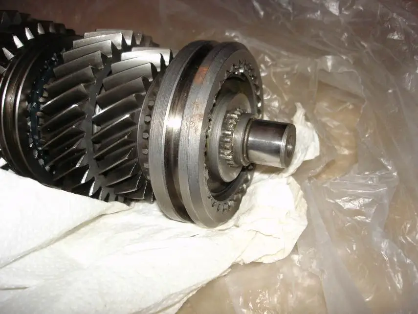

Hey guys. I am disassembling my mainshaft and can't get the rest of the gears off because of this mystery part. I really don't know what to call it......like a washer that is fixed to the shaft. BTW I had the tip resleeved a while back........ideas?

That's not an OEM part. Seems like it's part of the resleeving you had done. I can't tell from the picture how it's fixed to the shaft however so i can't really give you advice on how to remove it.
Removing it may detroy it and they you could be SOL when comes time to reassemble.

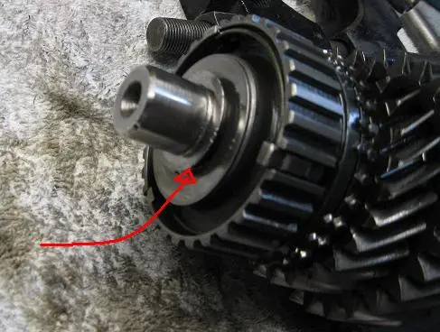

5L5-that's what I thought!! I know that isn't suppose to be there, thanks so much for the pic

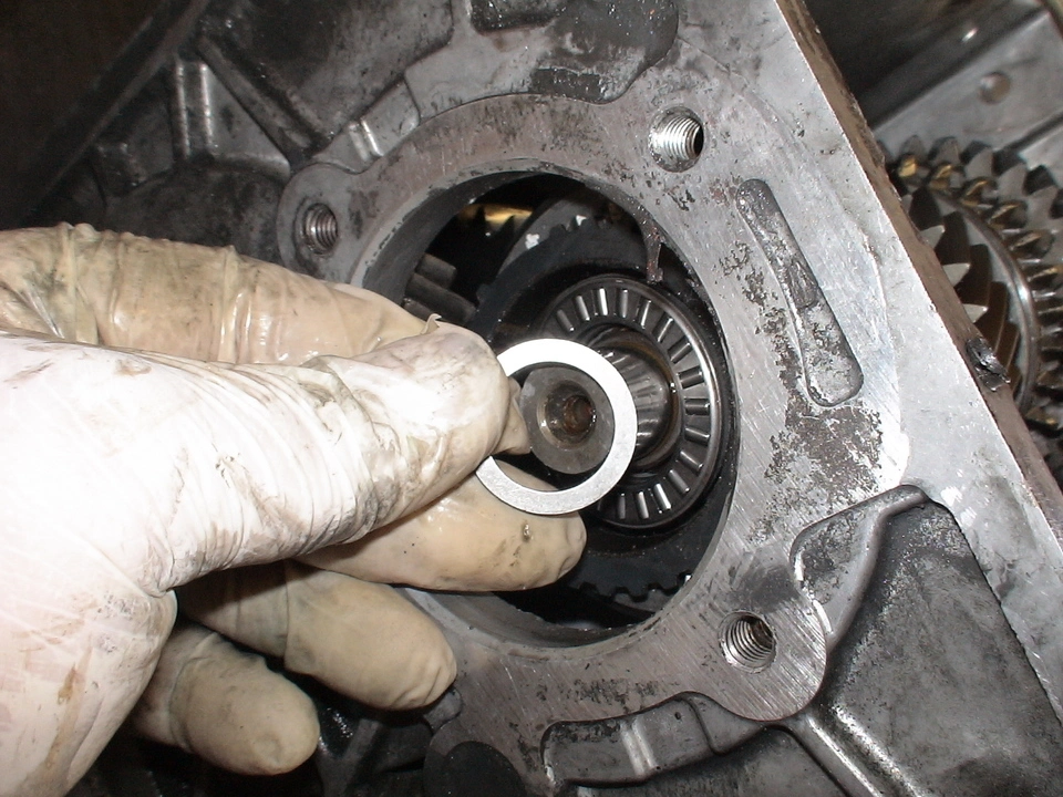

to me that looks like the small washer that goes on the tip to help oiling.
I've had them before where they stuck a little.

ok guys I found out what it was. The washer thing was actually the "spacer" that goes between the individual roller bearings and the thrust washer and bearing for the input. Where the hell can I get a new one?

I was very careful taking it off because I didn't want to scratch the mainshaft tip. I grabbed it with some pliers and worked it off. It wasn't on there that tight I was just didn't want to jump the gun and rip it off before I knew what it was.
Drew
there are only 4 things that go in that area...
1. the flat bearing
2. the flat bearing race
3. that round washer that then slips over the tip
4. the needle bearings that slide into the input
that's it.
is the washer bad?? just re use it
yeah it's bad. Its not even flat. Maybe whoever built the trans before me set the preload too tight so it was smashed against the step. This washer slides over the mainshaft tip
