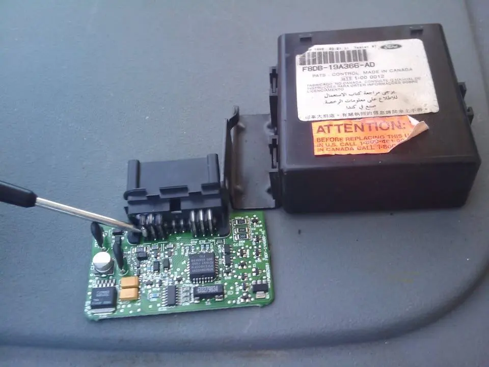

no saying this is your problem...awhile back i trying to help a guy on this site with a pats problem...
his was a 99 and ford refused to work on it because of the age of the car...
iirc his was a no start issue with injectors...he did find his problem..here is a pic of pats mod with a short inside the part
